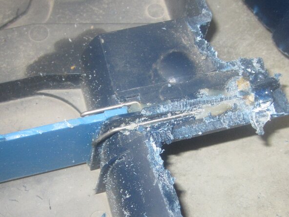

  2. iRobot Scooba 3xx Tank Teardown, Cutting Strategy: crwdns2935265:02crwdnd2935265:01crwdnd2935265:02crwdne2935265:0 iRobot Scooba 3xx Tank Teardown, Cutting Strategy: crwdns2935265:02crwdnd2935265:02crwdnd2935265:02crwdne2935265:0
    • The initial cuts were made along the red line and then on the seam on the back of the tank. IF I were to do this again, I would cut about 1/8" below the seam on the back of the tank.

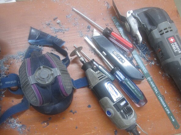

    • The second photo is the tools I used. The dust mask is a MUST HAVE and the Dremel with the rotary saw got the most use.
    • Not shown is eye protection because I am wearing it. If you do this, plastic bits will be flying all over.

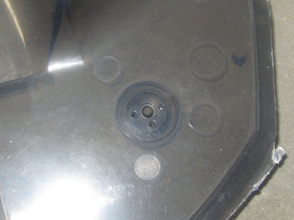

    • The third picture is a little flap valve that allows air to flow into the empty water tank as it empties. If the Scooba struggles to empty the clean water tank and the pump initially seems to be working, you can push a paperclip into three little holes to loosen this flap.

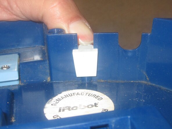

    • The tank covers can be salvaged by center punching the 4 plastic pins and drilling them very shallowly with a 9/64" drill. Try not to nick the rectangular bits.
    • Gently pry off the rectangular plastic washers and the covers should easily pull free.
    • The same procedure can be done for the tank these covers are going onto. A dab of hot glue could hold everything in place.
