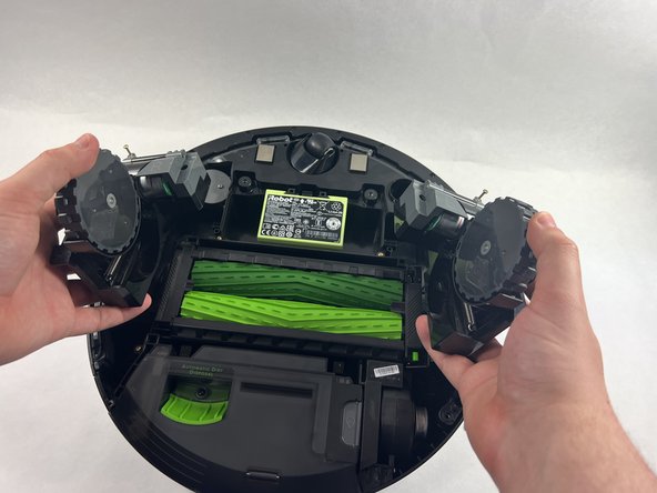

    • Flip the Roomba over so the underside is facing up.
    • Remove the 4 mm screw connecting the green side brush to the chassis using a Phillips #2 screwdriver.
    • Remove the green side brush.
  2. iRobot Roomba i7 Plus Drive Wheel Replacement, Back Plate: crwdns2935265:02crwdnd2935265:01crwdnd2935265:02crwdne2935265:0 iRobot Roomba i7 Plus Drive Wheel Replacement, Back Plate: crwdns2935265:02crwdnd2935265:02crwdnd2935265:02crwdne2935265:0
    • Remove the five screws from the underside of the Roomba using a Phillips #2 screwdriver.
    • Pull the back plate up and away from the Roomba to remove it from the device.
  3. iRobot Roomba i7 Plus Drive Wheel Replacement, Drive Wheel: crwdns2935265:03crwdnd2935265:01crwdnd2935265:02crwdne2935265:0 iRobot Roomba i7 Plus Drive Wheel Replacement, Drive Wheel: crwdns2935265:03crwdnd2935265:02crwdnd2935265:02crwdne2935265:0
    • Loosen the two captive screws from each wheel (four in total) using a Phillips #2 screwdriver.
    • Grab each wheel and gently pull them out.
