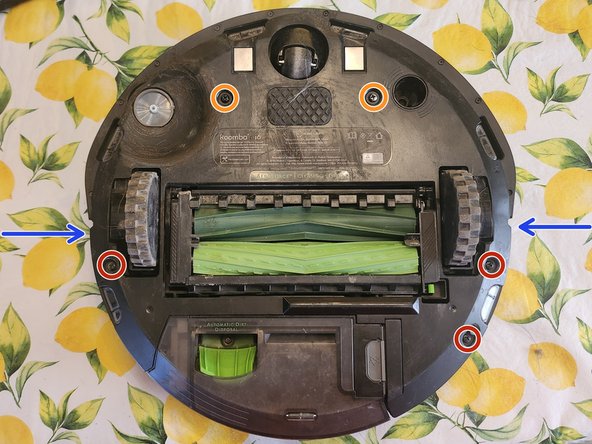

  1. iRobot Roomba i6 Battery Replacement, Remove the Bottom Cover: crwdns2935265:01crwdnd2935265:01crwdnd2935265:03crwdne2935265:0 iRobot Roomba i6 Battery Replacement, Remove the Bottom Cover: crwdns2935265:01crwdnd2935265:02crwdnd2935265:03crwdne2935265:0 iRobot Roomba i6 Battery Replacement, Remove the Bottom Cover: crwdns2935265:01crwdnd2935265:03crwdnd2935265:03crwdne2935265:0
    • Using your PH2 size screwdriver, remove the edge sweeping brush.
    • Using your PH2 size screwdriver, remove the 5 screws highlighted in the 2nd picture.
    • These top two screws highlighted in orange will unscrew completely if you keep going so be sure to stop unscrewing them as soon as you feel resistance.
    • Lift the bottom cover straight up off of the Roomba from the two spots the arrows are pointing to.

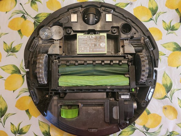

  2. iRobot Roomba i6 Battery Replacement, Remove the Battery: crwdns2935265:02crwdnd2935265:01crwdnd2935265:01crwdne2935265:0
    • Push the highlighted tab up while lifting the battery out of the Roomba.
    • During re-assembly, you just have to align the battery and push down until the tab clicks.
To install the new battery, follow these instructions in reverse order.
