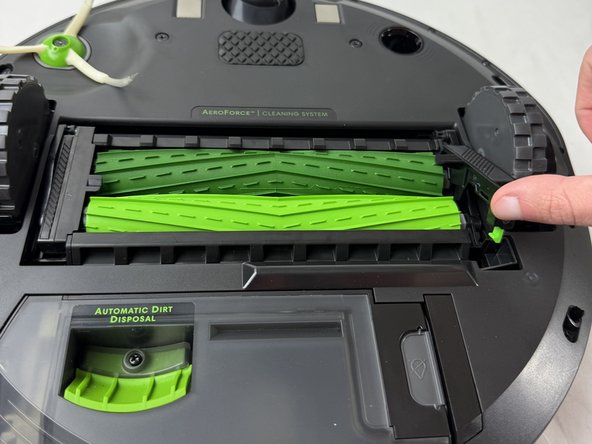

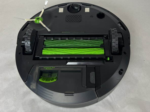

    • Turn your Roomba upside down with the light green rubber brush positioned closest to you.
  2. iRobot Roomba i4 Plus Roller Brushes Replacement: crwdns2935265:02crwdnd2935265:01crwdnd2935265:03crwdne2935265:0 iRobot Roomba i4 Plus Roller Brushes Replacement: crwdns2935265:02crwdnd2935265:02crwdnd2935265:03crwdne2935265:0 iRobot Roomba i4 Plus Roller Brushes Replacement: crwdns2935265:02crwdnd2935265:03crwdnd2935265:03crwdne2935265:0
    • Pull the small green tab below the right wheel upward and lift the side of the brush holder to unlock it.

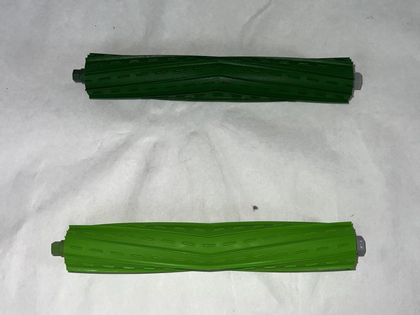

    • Lift the light green brush first, followed by the darker green brush.

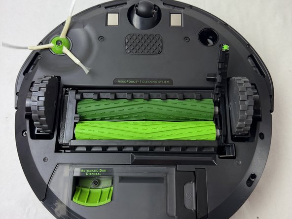

    • When installing the replacement brushes, refer to the bottom of the brush holder. It uses matching colors and shaped ends to indicate which brush goes on each side and the correct orientation.
