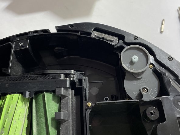

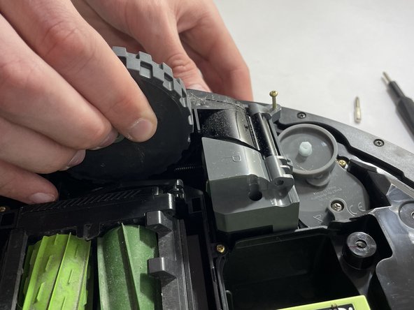

  5. iRobot Roomba e5 Wheels Replacement, Wheels: crwdns2935265:05crwdnd2935265:01crwdnd2935265:03crwdne2935265:0 iRobot Roomba e5 Wheels Replacement, Wheels: crwdns2935265:05crwdnd2935265:02crwdnd2935265:03crwdne2935265:0 iRobot Roomba e5 Wheels Replacement, Wheels: crwdns2935265:05crwdnd2935265:03crwdnd2935265:03crwdne2935265:0
    • Loosen the two captive screws closest to the wheel module using a Phillips #0 screwdriver.
  6. iRobot Roomba e5 Wheels Replacement: crwdns2935265:06crwdnd2935265:01crwdnd2935265:03crwdne2935265:0 iRobot Roomba e5 Wheels Replacement: crwdns2935265:06crwdnd2935265:02crwdnd2935265:03crwdne2935265:0 iRobot Roomba e5 Wheels Replacement: crwdns2935265:06crwdnd2935265:03crwdnd2935265:03crwdne2935265:0

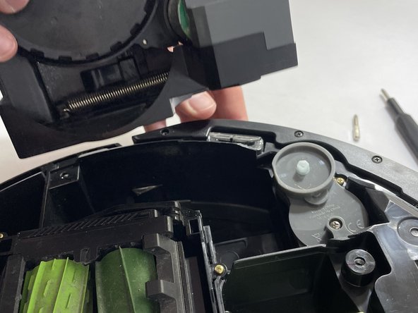

    • Pull the wheel module out of the Roomba, leaving an empty pocket.
    • Repeat Steps 5 and 6 for the opposite wheel.
  7. iRobot Roomba e5 Wheels Replacement: crwdns2935265:07crwdnd2935265:01crwdnd2935265:03crwdne2935265:0 iRobot Roomba e5 Wheels Replacement: crwdns2935265:07crwdnd2935265:02crwdnd2935265:03crwdne2935265:0 iRobot Roomba e5 Wheels Replacement: crwdns2935265:07crwdnd2935265:03crwdnd2935265:03crwdne2935265:0
    • insert the new wheel module into the wheel pocket.
