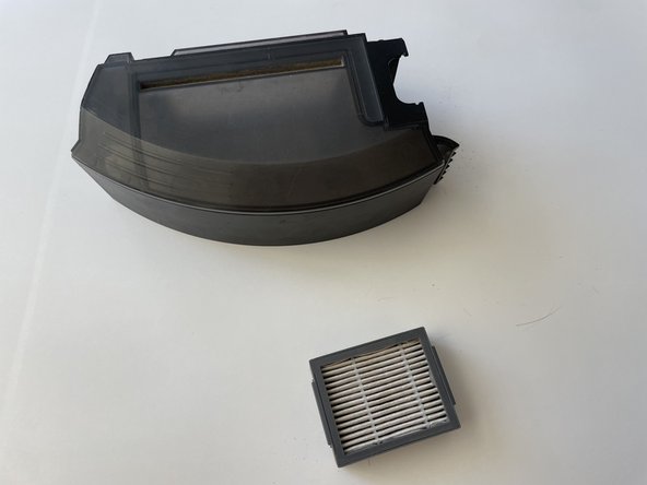

    • To remove the dust bin, press down on the button with a “trash bin” drawing by the side of the vacuum.
    • While pressing the button, gently pull the dust bin out.
    • When removing the dust bin, dust can tip over the surface and create a mess.
  4. iRobot Roomba e5 Maintenance: crwdns2935265:04crwdnd2935265:01crwdnd2935265:02crwdne2935265:0 iRobot Roomba e5 Maintenance: crwdns2935265:04crwdnd2935265:02crwdnd2935265:02crwdne2935265:0
    • To remove the filter located at the right side of the dust bin, press the filter on top and at the bottom and pull.
  5. iRobot Roomba e5 Maintenance: crwdns2935265:05crwdnd2935265:01crwdnd2935265:03crwdne2935265:0 iRobot Roomba e5 Maintenance: crwdns2935265:05crwdnd2935265:02crwdnd2935265:03crwdne2935265:0 iRobot Roomba e5 Maintenance: crwdns2935265:05crwdnd2935265:03crwdnd2935265:03crwdne2935265:0
    • Clean every part of the vacuum thoroughly with a dust rag or paper towel and Q-tip.
