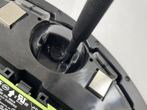

iRobot Roomba e5 Caster Wheel Replacement
  1. iRobot Roomba e5 Caster Wheel Replacement, Caster Wheel: crwdns2935265:01crwdnd2935265:01crwdnd2935265:02crwdne2935265:0 iRobot Roomba e5 Caster Wheel Replacement, Caster Wheel: crwdns2935265:01crwdnd2935265:02crwdnd2935265:02crwdne2935265:0
    • Use an opening tool to pry beneath the grey ring on each side of the wheel until it pops out.
  2. iRobot Roomba e5 Caster Wheel Replacement: crwdns2935265:02crwdnd2935265:01crwdnd2935265:02crwdne2935265:0 iRobot Roomba e5 Caster Wheel Replacement: crwdns2935265:02crwdnd2935265:02crwdnd2935265:02crwdne2935265:0
    • Pull the wheel out of the vacuum.
    • Dirt and debris can be caught under the wheel and may lead to decreased mobility. Try cleaning out the debris before replacing the wheel.
  3. iRobot Roomba e5 Caster Wheel Replacement: crwdns2935265:03crwdnd2935265:01crwdnd2935265:03crwdne2935265:0 iRobot Roomba e5 Caster Wheel Replacement: crwdns2935265:03crwdnd2935265:02crwdnd2935265:03crwdne2935265:0 iRobot Roomba e5 Caster Wheel Replacement: crwdns2935265:03crwdnd2935265:03crwdnd2935265:03crwdne2935265:0
    • Remove two 10 mm screws from the wheel housing using a Phillips #1 screwdriver.
  4. iRobot Roomba e5 Caster Wheel Replacement: crwdns2935265:04crwdnd2935265:01crwdnd2935265:01crwdne2935265:0
    • Pull the wheel housing out of the vacuum.
