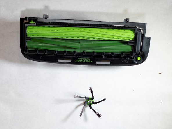

  4. iRobot Roomba S9 Plus Corner Brush Replacement: crwdns2935265:04crwdnd2935265:01crwdnd2935265:02crwdne2935265:0 iRobot Roomba S9 Plus Corner Brush Replacement: crwdns2935265:04crwdnd2935265:02crwdnd2935265:02crwdne2935265:0
    • Remove the brush module by pulling up from the sides.

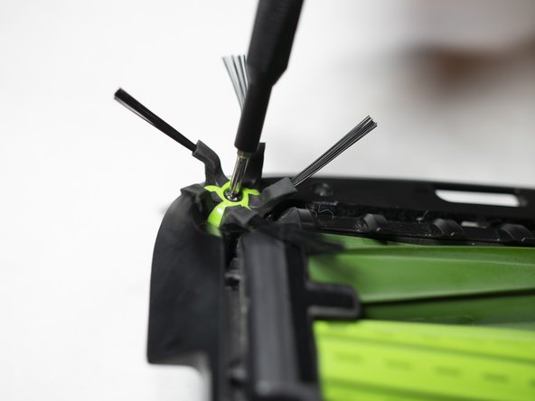

  5. iRobot Roomba S9 Plus Corner Brush Replacement: crwdns2935265:05crwdnd2935265:01crwdnd2935265:03crwdne2935265:0 iRobot Roomba S9 Plus Corner Brush Replacement: crwdns2935265:05crwdnd2935265:02crwdnd2935265:03crwdne2935265:0 iRobot Roomba S9 Plus Corner Brush Replacement: crwdns2935265:05crwdnd2935265:03crwdnd2935265:03crwdne2935265:0
    • Unscrew the 7mm Phillips #2 screw holding the corner brush head in place.

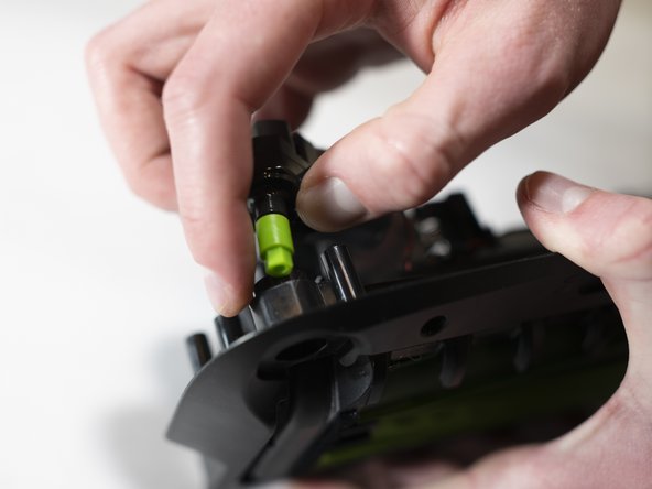

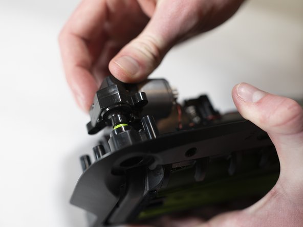

  7. iRobot Roomba S9 Plus Corner Brush Replacement: crwdns2935265:07crwdnd2935265:01crwdnd2935265:03crwdne2935265:0 iRobot Roomba S9 Plus Corner Brush Replacement: crwdns2935265:07crwdnd2935265:02crwdnd2935265:03crwdne2935265:0 iRobot Roomba S9 Plus Corner Brush Replacement: crwdns2935265:07crwdnd2935265:03crwdnd2935265:03crwdne2935265:0
    • Carefully take the motor axle from its housing.

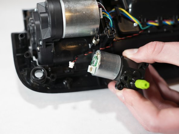

  8. iRobot Roomba S9 Plus Corner Brush Replacement: crwdns2935265:08crwdnd2935265:01crwdnd2935265:02crwdne2935265:0 iRobot Roomba S9 Plus Corner Brush Replacement: crwdns2935265:08crwdnd2935265:02crwdnd2935265:02crwdne2935265:0
    • Disconnect the wire connecting the motor using tweezers to pull out the connector.
