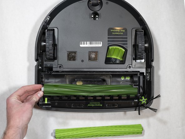

    • Push the grey tab by the top left corner of the brushes to release the retaining arm.
  2. iRobot Roomba S9 Plus Brush Replacement: crwdns2935265:02crwdnd2935265:01crwdnd2935265:01crwdne2935265:0
    • Lift the retaining arm away from the brushes.
  3. iRobot Roomba S9 Plus Brush Replacement: crwdns2935265:03crwdnd2935265:01crwdnd2935265:02crwdne2935265:0 iRobot Roomba S9 Plus Brush Replacement: crwdns2935265:03crwdnd2935265:02crwdnd2935265:02crwdne2935265:0
    • Individually lift the brushes from the left side and remove them from the cleaning head module.
