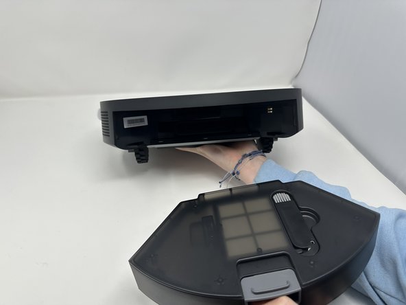

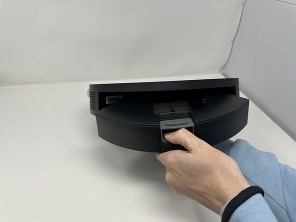

    • Press the grey button located towards the back of the Roomba Essential Robot.
    • While the button is pressed, slide the dustbin out of the vacuum.

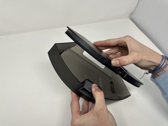

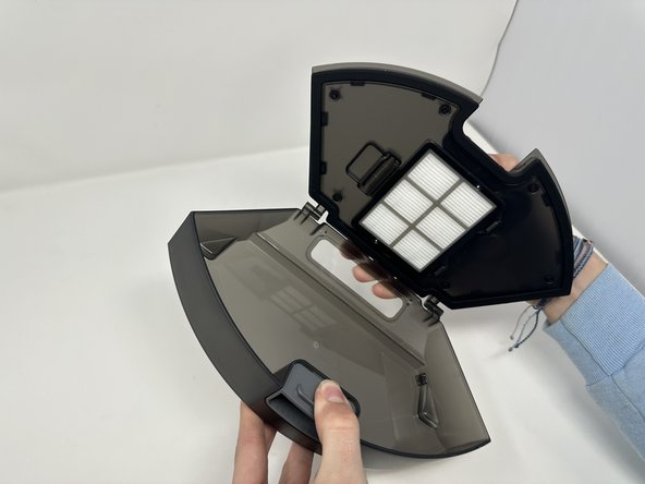

    • Press down on the grey button on the dustbin with your thumb.
    • While you are holding the button down, use your other thumb to open the lid.

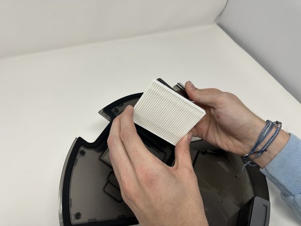

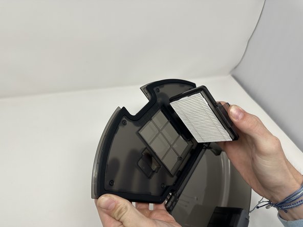

    • Put pressure on the latch directly to the side of the filter to open the filter compartment.
    • Remove the filter.
