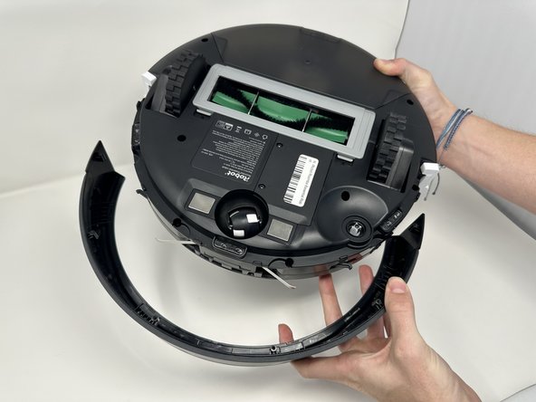

    • Remove the six screws from the thin edge on the backside of the Roomba using a Phillips #00 screwdriver.
  2. iRobot Roomba Essential Robot Bumper Replacement: crwdns2935265:02crwdnd2935265:01crwdnd2935265:01crwdne2935265:0
    • Separate the bumper from the Roomba.
  3. iRobot Roomba Essential Robot Bumper Replacement: crwdns2935265:03crwdnd2935265:01crwdnd2935265:02crwdne2935265:0 iRobot Roomba Essential Robot Bumper Replacement: crwdns2935265:03crwdnd2935265:02crwdnd2935265:02crwdne2935265:0
    • Place your fingers against the white tabs on the side of the Roomba and remove the bumper.
