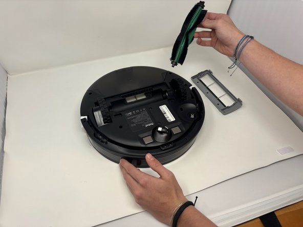

    • Place the Roomba on its back.
    • Press both clips of the brush cover.
    • Lift up and remove the brush cover.

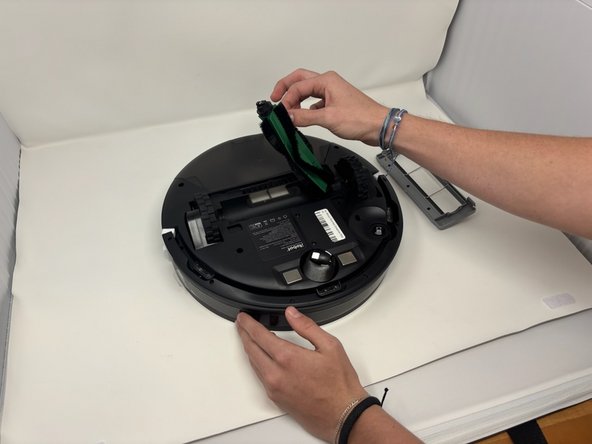

    • Lift the brush from the right side.
    • Pull the brush out.
