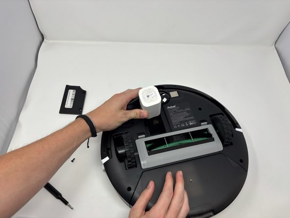

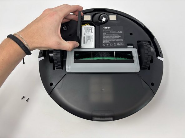

    • Flip the Roomba on its backside.
    • Remove the two 12.7 mm screws on the panel above the brushes using a Phillips #1 screwdriver.

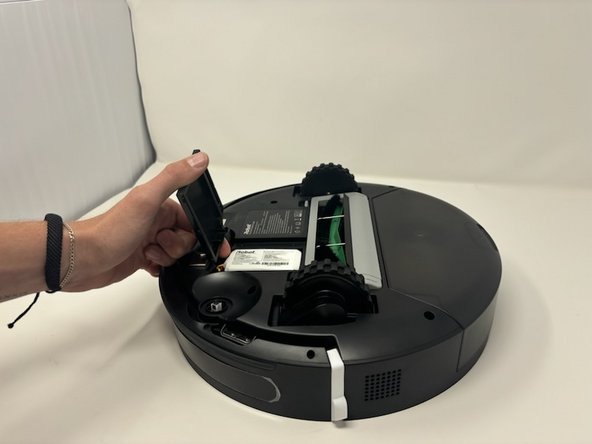

  2. iRobot Roomba Essential Robot Battery Replacement: crwdns2935265:02crwdnd2935265:01crwdnd2935265:03crwdne2935265:0 iRobot Roomba Essential Robot Battery Replacement: crwdns2935265:02crwdnd2935265:02crwdnd2935265:03crwdne2935265:0 iRobot Roomba Essential Robot Battery Replacement: crwdns2935265:02crwdnd2935265:03crwdnd2935265:03crwdne2935265:0
    • Remove the panel from the iRobot Roomba Essential Robot.
  3. iRobot Roomba Essential Robot Battery Replacement: crwdns2935265:03crwdnd2935265:01crwdnd2935265:03crwdne2935265:0 iRobot Roomba Essential Robot Battery Replacement: crwdns2935265:03crwdnd2935265:02crwdnd2935265:03crwdne2935265:0 iRobot Roomba Essential Robot Battery Replacement: crwdns2935265:03crwdnd2935265:03crwdnd2935265:03crwdne2935265:0

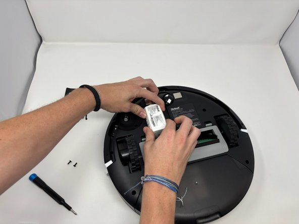

    • Place fingers along the side of the battery.
    • Pull upwards to remove the battery from its compartment.
    • Hold the battery to the side of the vacuum.

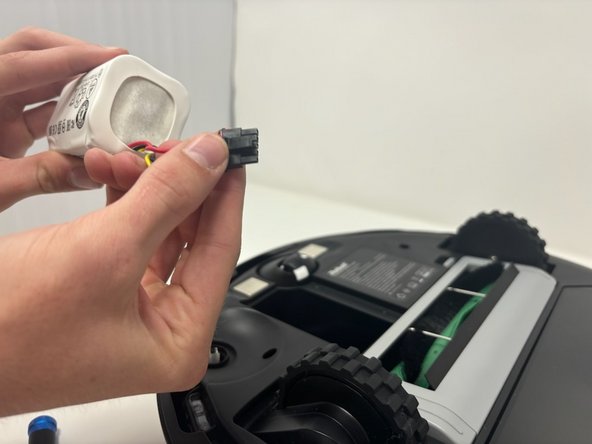

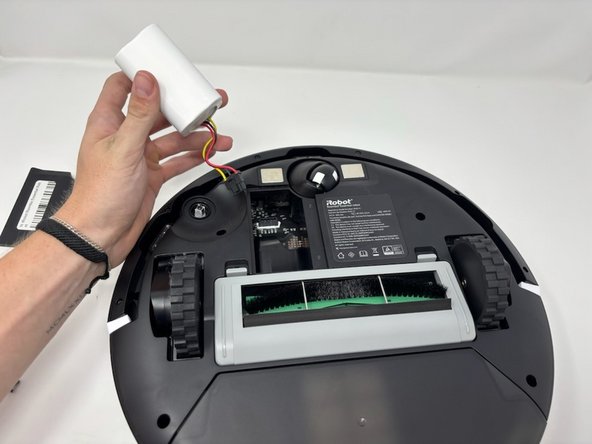

  4. iRobot Roomba Essential Robot Battery Replacement: crwdns2935265:04crwdnd2935265:01crwdnd2935265:03crwdne2935265:0 iRobot Roomba Essential Robot Battery Replacement: crwdns2935265:04crwdnd2935265:02crwdnd2935265:03crwdne2935265:0 iRobot Roomba Essential Robot Battery Replacement: crwdns2935265:04crwdnd2935265:03crwdnd2935265:03crwdne2935265:0
    • Apply pressure to the clip holding the battery into the vacuum.
    • Pull the battery and its attached cords from the inside of the Roomba.

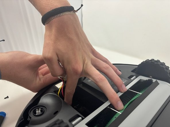

  5. iRobot Roomba Essential Robot Battery Replacement: crwdns2935265:05crwdnd2935265:01crwdnd2935265:02crwdne2935265:0 iRobot Roomba Essential Robot Battery Replacement: crwdns2935265:05crwdnd2935265:02crwdnd2935265:02crwdne2935265:0
    • Remove the battery from the vacuum.
