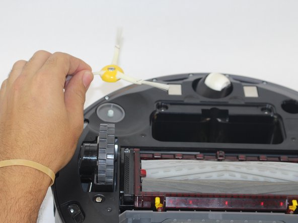

  4. iRobot Roomba 980 Rear Wheels, Rear Wheels: crwdns2935265:04crwdnd2935265:01crwdnd2935265:02crwdne2935265:0 iRobot Roomba 980 Rear Wheels, Rear Wheels: crwdns2935265:04crwdnd2935265:02crwdnd2935265:02crwdne2935265:0
    • Loosen the screw on the side brush.
    • Lift the side brush from the device.
