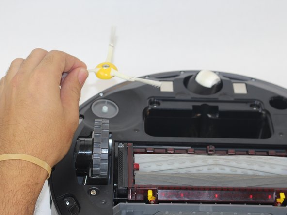

  6. iRobot Roomba 980 Motherboard Replacement: crwdns2935265:06crwdnd2935265:01crwdnd2935265:02crwdne2935265:0 iRobot Roomba 980 Motherboard Replacement: crwdns2935265:06crwdnd2935265:02crwdnd2935265:02crwdne2935265:0
    • Loosen the screw holding the side brush in place, by using a Phillips #1 screwdriver
    • The screw is attached to the side brush and does not come out completely.
    • Lift the side brush.

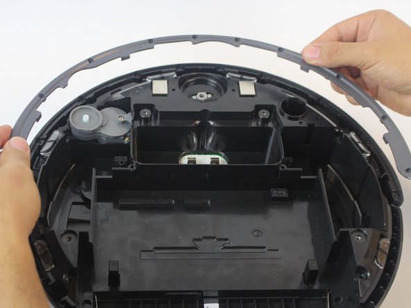

  7. iRobot Roomba 980 Motherboard Replacement: crwdns2935265:07crwdnd2935265:01crwdnd2935265:02crwdne2935265:0 iRobot Roomba 980 Motherboard Replacement: crwdns2935265:07crwdnd2935265:02crwdnd2935265:02crwdne2935265:0

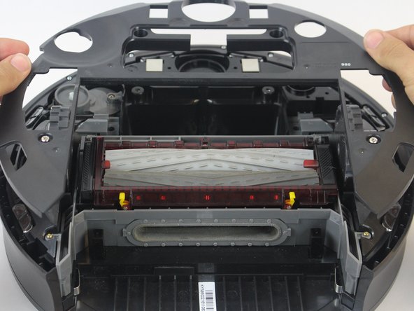

    • Remove the two 11.5mm screws holding down the bottom plate using a Phillips #1 screwdriver
    • Carefully lift the bottom plate.

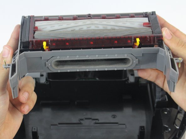

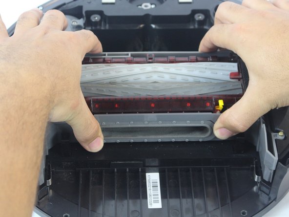

  8. iRobot Roomba 980 Motherboard Replacement: crwdns2935265:08crwdnd2935265:01crwdnd2935265:03crwdne2935265:0 iRobot Roomba 980 Motherboard Replacement: crwdns2935265:08crwdnd2935265:02crwdnd2935265:03crwdne2935265:0 iRobot Roomba 980 Motherboard Replacement: crwdns2935265:08crwdnd2935265:03crwdnd2935265:03crwdne2935265:0
    • Remove the four 15.8mm gold screws around the brush module using the Phillips #1 screwdriver.
    • Lift the brush module carefully using both hands.

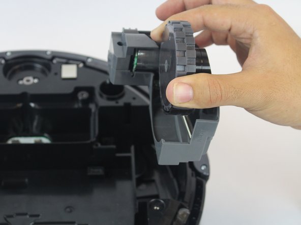

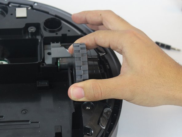

  9. iRobot Roomba 980 Motherboard Replacement: crwdns2935265:09crwdnd2935265:01crwdnd2935265:03crwdne2935265:0 iRobot Roomba 980 Motherboard Replacement: crwdns2935265:09crwdnd2935265:02crwdnd2935265:03crwdne2935265:0 iRobot Roomba 980 Motherboard Replacement: crwdns2935265:09crwdnd2935265:03crwdnd2935265:03crwdne2935265:0
    • Remove the three 15.8mm gold screws with a Phillips #1 screwdriver.
    • Lift the wheel module to remove it from the vacuum.
    • Remove the other wheel by repeating these steps.

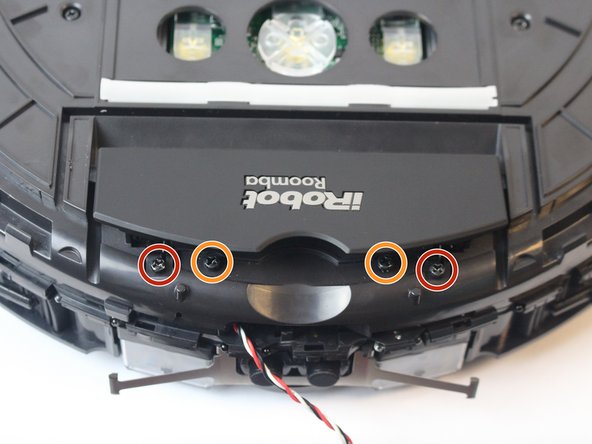

  12. iRobot Roomba 980 Motherboard Replacement: crwdns2935265:012crwdnd2935265:01crwdnd2935265:01crwdne2935265:0
    • Flip the sensor over and use a Phillips #1 screwdriver to remove the two 3.8 mm silver screws that hold the sensors to the panel.
    • While the two 3.8mm screws look very similar to the 6.1mm screws, the two sizes are not interchangeable, so make sure not to mix the two sizes up when reassembling the Roomba.
    • Once removed, pull the panel away carefully.
