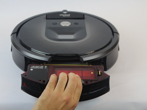

  4. iRobot Roomba 980 Brush Module Replacement, Brush Module: crwdns2935265:04crwdnd2935265:01crwdnd2935265:03crwdne2935265:0 iRobot Roomba 980 Brush Module Replacement, Brush Module: crwdns2935265:04crwdnd2935265:02crwdnd2935265:03crwdne2935265:0 iRobot Roomba 980 Brush Module Replacement, Brush Module: crwdns2935265:04crwdnd2935265:03crwdnd2935265:03crwdne2935265:0
    • Press down on the button on the rear of the device.
    • Pull bin towards you to remove it.

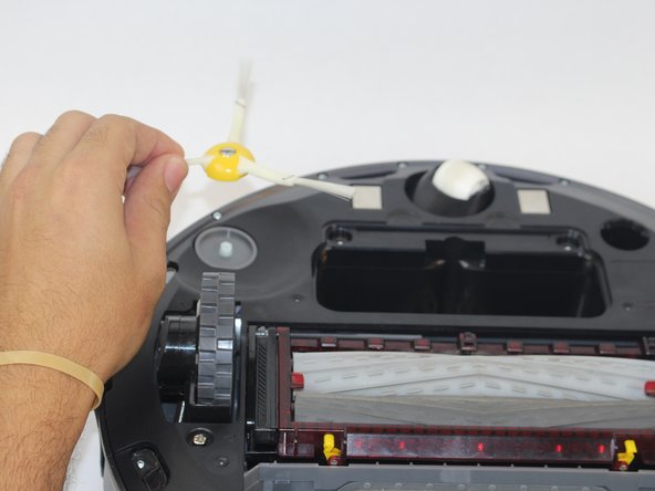

  5. iRobot Roomba 980 Brush Module Replacement: crwdns2935265:05crwdnd2935265:01crwdnd2935265:02crwdne2935265:0 iRobot Roomba 980 Brush Module Replacement: crwdns2935265:05crwdnd2935265:02crwdnd2935265:02crwdne2935265:0
    • Loosen the screw holding the side brush in place.
    • The screw is attached to the side brush and does not come out completely.
    • Lift the side brush.

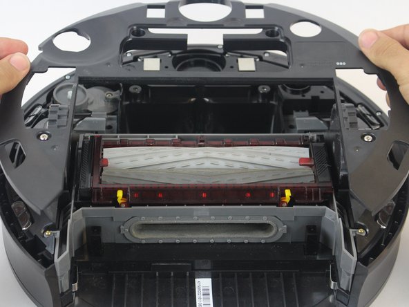

  6. iRobot Roomba 980 Brush Module Replacement: crwdns2935265:06crwdnd2935265:01crwdnd2935265:02crwdne2935265:0 iRobot Roomba 980 Brush Module Replacement: crwdns2935265:06crwdnd2935265:02crwdnd2935265:02crwdne2935265:0
    • Remove the (2) 11.5mm Phillips #1 screws holding down the bottom plate.
    • Carefully lift the bottom plate.

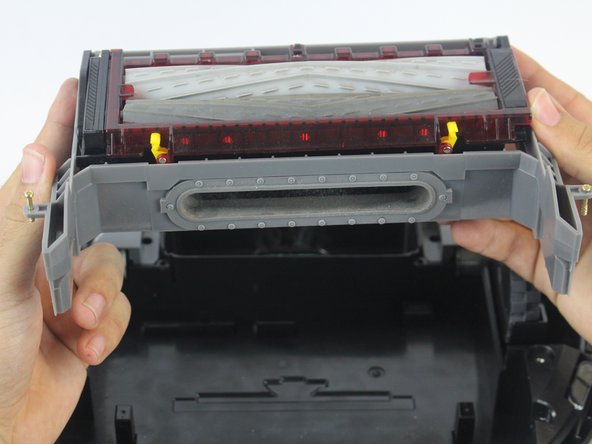

  7. iRobot Roomba 980 Brush Module Replacement: crwdns2935265:07crwdnd2935265:01crwdnd2935265:01crwdne2935265:0
    • Remove the (4) 15.8mm Phillips #1 gold screws around the brush module.
  8. iRobot Roomba 980 Brush Module Replacement: crwdns2935265:08crwdnd2935265:01crwdnd2935265:02crwdne2935265:0 iRobot Roomba 980 Brush Module Replacement: crwdns2935265:08crwdnd2935265:02crwdnd2935265:02crwdne2935265:0
    • Lift the brush module carefully using both hands.
