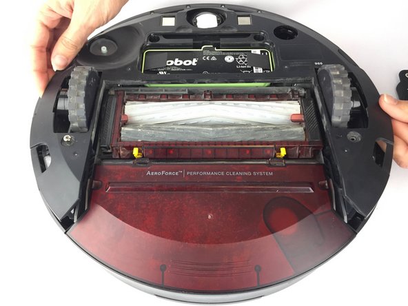

    • Turn the Roomba upside down and orient it so that the wheels are facing upwards and the dustbin is furthest from you.
  2. iRobot Roomba 960 Side Wheels Replacement: crwdns2935265:02crwdnd2935265:01crwdnd2935265:01crwdne2935265:0
    • With the Phillips #1 screwdriver, remove the two 11.4mm screws.
  3. iRobot Roomba 960 Side Wheels Replacement: crwdns2935265:03crwdnd2935265:01crwdnd2935265:01crwdne2935265:0
    • Lift the plastic cover to access the battery.
  4. iRobot Roomba 960 Side Wheels Replacement: crwdns2935265:04crwdnd2935265:01crwdnd2935265:03crwdne2935265:0 iRobot Roomba 960 Side Wheels Replacement: crwdns2935265:04crwdnd2935265:02crwdnd2935265:03crwdne2935265:0 iRobot Roomba 960 Side Wheels Replacement: crwdns2935265:04crwdnd2935265:03crwdnd2935265:03crwdne2935265:0
    • Using the two black flaps located at the sides of the battery, pull it towards you.
    • Carefully remove the battery.

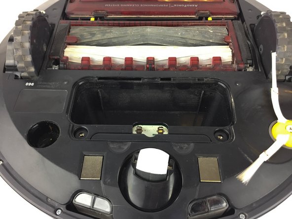

  5. iRobot Roomba 960 Side Wheels Replacement, Side-Brush: crwdns2935265:05crwdnd2935265:01crwdnd2935265:01crwdne2935265:0
    • With the Flathead 2.5mm screwdriver remove the 7.9mm screw from the side-brush.
  6. iRobot Roomba 960 Side Wheels Replacement: crwdns2935265:06crwdnd2935265:01crwdnd2935265:01crwdne2935265:0
    • Pull the side-brush towards you.
    • Carefully remove the side-brush.

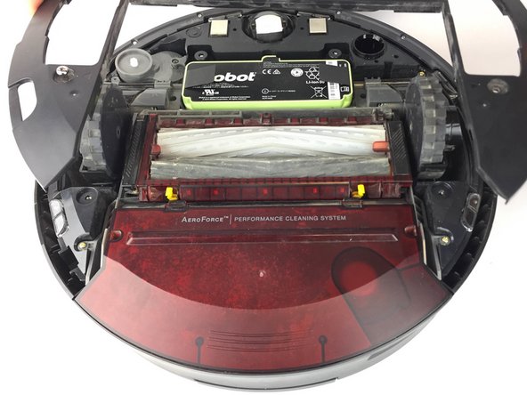

  7. iRobot Roomba 960 Side Wheels Replacement, Side Wheels: crwdns2935265:07crwdnd2935265:01crwdnd2935265:03crwdne2935265:0 iRobot Roomba 960 Side Wheels Replacement, Side Wheels: crwdns2935265:07crwdnd2935265:02crwdnd2935265:03crwdne2935265:0 iRobot Roomba 960 Side Wheels Replacement, Side Wheels: crwdns2935265:07crwdnd2935265:03crwdnd2935265:03crwdne2935265:0
    • Using a Phillips #1 screwdriver, unscrew the two 11.4mm screws that hold the bottom cover.
    • Lift to remove the plastic back panel.
  8. iRobot Roomba 960 Side Wheels Replacement: crwdns2935265:08crwdnd2935265:01crwdnd2935265:01crwdne2935265:0
    • Using a Phillips #1 screwdriver, remove the three gold 15.5 mm screws.
  9. iRobot Roomba 960 Side Wheels Replacement: crwdns2935265:09crwdnd2935265:01crwdnd2935265:02crwdne2935265:0 iRobot Roomba 960 Side Wheels Replacement: crwdns2935265:09crwdnd2935265:02crwdnd2935265:02crwdne2935265:0
    • Carefully remove the wheel.

In steps 2, 3 and 4 you show how to remove the battery, but from steps 5-9 you show the battery installed. Is it required to remove the battery?
If this is a required safety procedure to remove the battery, I would suggest to edit the pictures in steps 5-9 showing the battery removed in those steps. If it is not required or stated in the repair instructions I would suggest to edit step 2 stating it is "Your suggestion but not necessary to remove the battery" or remove steps 2-4 & renumber the following steps.
I did something like this on another site & caught a lot of flack over it. In that one, I took pictures as I did the repair with the battery in, but forgot to mention it would be safer to remove the battery (only suggested in the instructions) to prevent damage from a short. But being a mechanic & knowing I could do the repair safely w/o removing the battery I didn't show the battery removed & someone damaged their equipment. Just a suggestion to save you from a possible big headache.
