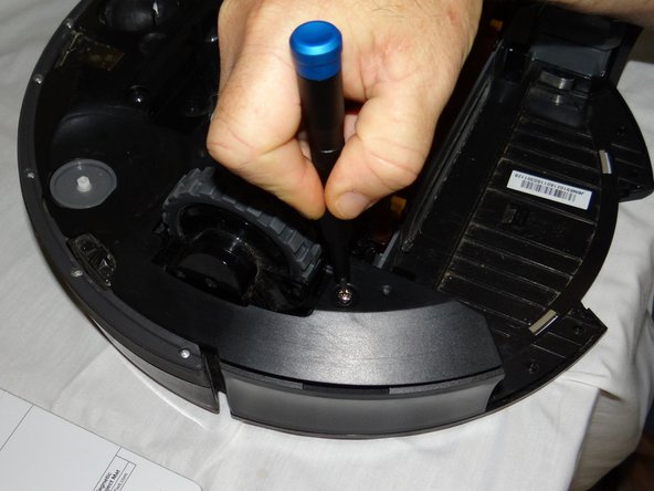

  2. iRobot Roomba 891 Extractor Assembly Replacement: crwdns2935265:02crwdnd2935265:01crwdnd2935265:01crwdne2935265:0
    • Unscrew both the 11mm Phillips #2 screws from the battery cover and remove cover from the Roomba.
    • These captive screws are not intended to be removed from the cover.

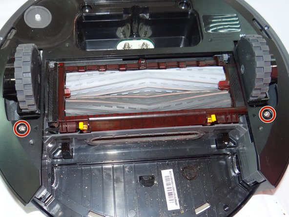

  7. iRobot Roomba 891 Extractor Assembly Replacement: crwdns2935265:07crwdnd2935265:01crwdnd2935265:03crwdne2935265:0 iRobot Roomba 891 Extractor Assembly Replacement: crwdns2935265:07crwdnd2935265:02crwdnd2935265:03crwdne2935265:0 iRobot Roomba 891 Extractor Assembly Replacement: crwdns2935265:07crwdnd2935265:03crwdnd2935265:03crwdne2935265:0
    • Unscrew the 2 phillips #2 11mm screws from roomba.
    • These captive screws will remain in the bottom cover after being loosened.

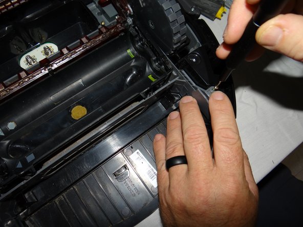

    • Close the cover and remove the four 11mm Phillips #00 screws from the assembly.
  11. iRobot Roomba 891 Extractor Assembly Replacement: crwdns2935265:011crwdnd2935265:01crwdnd2935265:01crwdne2935265:0
    • Grasp the center of the assembly and remove from the roomba.
