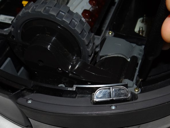

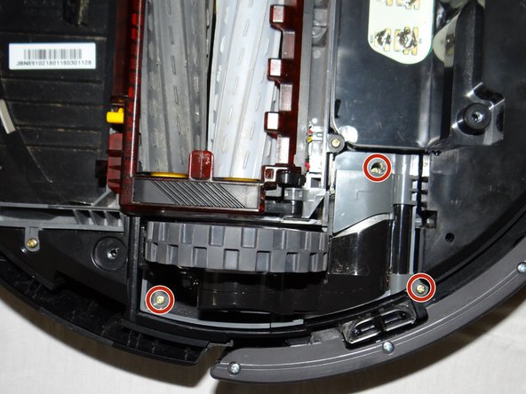

  8. iRobot Roomba 891 Drive Wheels Replacement: crwdns2935265:08crwdnd2935265:01crwdnd2935265:03crwdne2935265:0 iRobot Roomba 891 Drive Wheels Replacement: crwdns2935265:08crwdnd2935265:02crwdnd2935265:03crwdne2935265:0 iRobot Roomba 891 Drive Wheels Replacement: crwdns2935265:08crwdnd2935265:03crwdnd2935265:03crwdne2935265:0
    • Unscrew three Phillips #00 gold 11mm screws from the drive module.
    • Both modules have the same number of screws and are mirror images of each other.
    • Left module is shown in the photos.
  9. iRobot Roomba 891 Drive Wheels Replacement: crwdns2935265:09crwdnd2935265:01crwdnd2935265:01crwdne2935265:0
    • Grasp wheel module and remove from roomba.
    • Inspect housing for debris.
