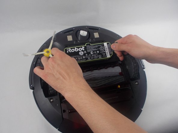

    3. iRobot Roomba 890 Side Brush Module Replacement: crwdns2935265:03crwdnd2935265:01crwdnd2935265:02crwdne2935265:0 iRobot Roomba 890 Side Brush Module Replacement: crwdns2935265:03crwdnd2935265:02crwdnd2935265:02crwdne2935265:0
      • Pull directly up on the grey pull tabs to remove the battery.

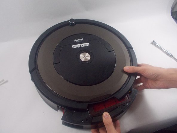

    4. iRobot Roomba 890 Side Brush Module Replacement: crwdns2935265:04crwdnd2935265:01crwdnd2935265:01crwdne2935265:0
      • Lift off the baseplate.
    5. iRobot Roomba 890 Side Brush Module Replacement: crwdns2935265:05crwdnd2935265:01crwdnd2935265:02crwdne2935265:0 iRobot Roomba 890 Side Brush Module Replacement: crwdns2935265:05crwdnd2935265:02crwdnd2935265:02crwdne2935265:0
      • Press the dustbin release button and pull it straight out.

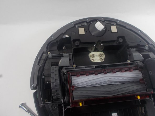

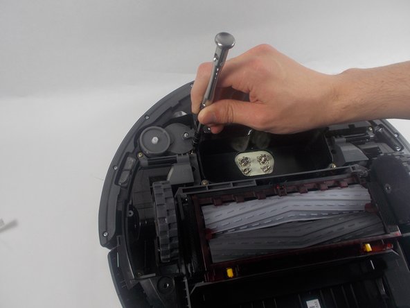

    6. iRobot Roomba 890 Side Brush Module Replacement: crwdns2935265:06crwdnd2935265:01crwdnd2935265:02crwdne2935265:0 iRobot Roomba 890 Side Brush Module Replacement: crwdns2935265:06crwdnd2935265:02crwdnd2935265:02crwdne2935265:0
      • On the underside of the Roomba, use a Phillips #1 screwdriver to remove the two 15.5 mm screws.
    7. iRobot Roomba 890 Side Brush Module Replacement: crwdns2935265:07crwdnd2935265:01crwdnd2935265:02crwdne2935265:0 iRobot Roomba 890 Side Brush Module Replacement: crwdns2935265:07crwdnd2935265:02crwdnd2935265:02crwdne2935265:0
      • Grip the side brush module casing and lift it out vertically, perpendicular to the Roomba.
