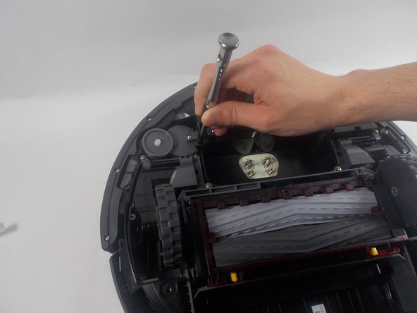

    • Use a Phillips #2 screwdriver to remove the 7.7 mm screw securing the side brush-head.
    • Remove the yellow brush head.
  2. iRobot Roomba 890 Motorized Wheel Module Replacement: crwdns2935265:02crwdnd2935265:01crwdnd2935265:01crwdne2935265:0
    • Place the Roomba with its bottom facing toward you.
    • Use a Phillips #2 screwdriver to remove the four 11 mm screws.
  3. iRobot Roomba 890 Motorized Wheel Module Replacement: crwdns2935265:03crwdnd2935265:01crwdnd2935265:02crwdne2935265:0 iRobot Roomba 890 Motorized Wheel Module Replacement: crwdns2935265:03crwdnd2935265:02crwdnd2935265:02crwdne2935265:0
    • Remove the battery by pulling directly up on the grey pull tabs.
  4. iRobot Roomba 890 Motorized Wheel Module Replacement: crwdns2935265:04crwdnd2935265:01crwdnd2935265:01crwdne2935265:0
    • Lift off the baseplate.
  5. iRobot Roomba 890 Motorized Wheel Module Replacement: crwdns2935265:05crwdnd2935265:01crwdnd2935265:02crwdne2935265:0 iRobot Roomba 890 Motorized Wheel Module Replacement: crwdns2935265:05crwdnd2935265:02crwdnd2935265:02crwdne2935265:0
    • Remove the collection bin by pressing the release button on the top side of the Roomba and pulling straight out.
  6. iRobot Roomba 890 Motorized Wheel Module Replacement: crwdns2935265:06crwdnd2935265:01crwdnd2935265:02crwdne2935265:0 iRobot Roomba 890 Motorized Wheel Module Replacement: crwdns2935265:06crwdnd2935265:02crwdnd2935265:02crwdne2935265:0
    • On the underside of the Roomba, use a Phillips #1 screwdriver to remove the three 15.5 mm screws.
  7. iRobot Roomba 890 Motorized Wheel Module Replacement: crwdns2935265:07crwdnd2935265:01crwdnd2935265:01crwdne2935265:0
    • Grip both sides of the casing and pull it straight out.
