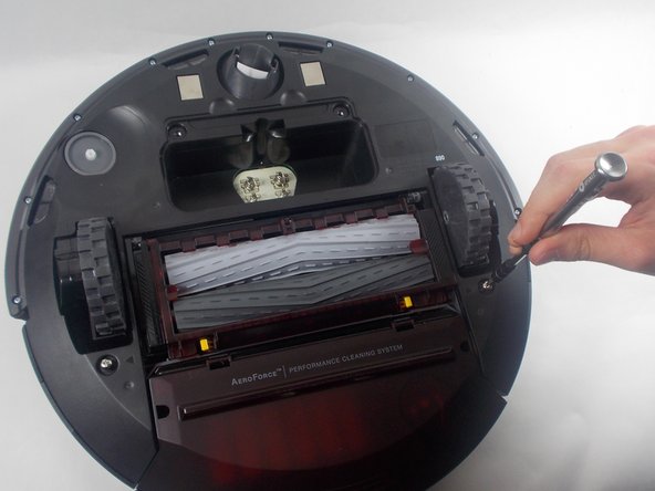

    • Use a Phillips #2 screwdriver to remove the one 7.7 mm screw.
    • Remove the yellow brush head.

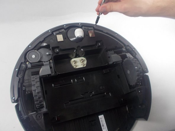

    • Use a Phillips #2 screwdriver to unscrew the two 11 mm screws.
    • Lift the baseplate up and off.

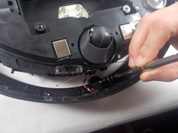

  6. iRobot Roomba 890 IR Sensor Replacement: crwdns2935265:06crwdnd2935265:01crwdnd2935265:02crwdne2935265:0 iRobot Roomba 890 IR Sensor Replacement: crwdns2935265:06crwdnd2935265:02crwdnd2935265:02crwdne2935265:0
    • Use a Phillips #2 screwdriver to remove the two 7.5 mm screws holding the IR sensor in place.

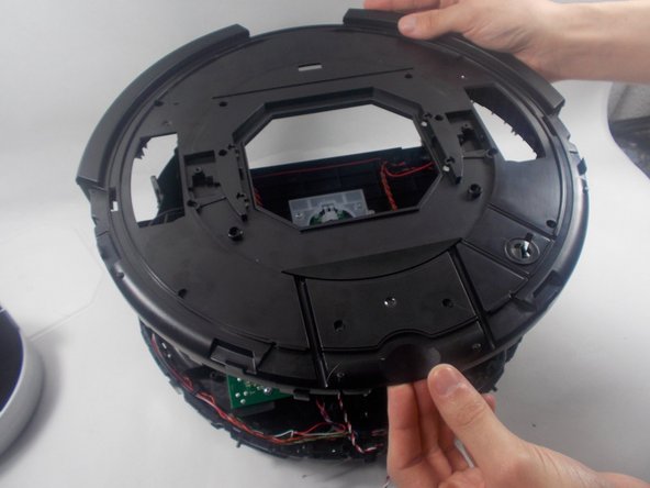

    • Use an iFixit opening tool to remove the outer plastic covering from the top of the Roomba.
  8. iRobot Roomba 890 IR Sensor Replacement: crwdns2935265:08crwdnd2935265:01crwdnd2935265:03crwdne2935265:0 iRobot Roomba 890 IR Sensor Replacement: crwdns2935265:08crwdnd2935265:02crwdnd2935265:03crwdne2935265:0 iRobot Roomba 890 IR Sensor Replacement: crwdns2935265:08crwdnd2935265:03crwdnd2935265:03crwdne2935265:0

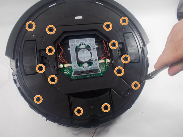

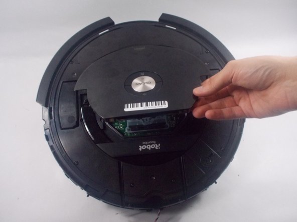

    • Use a Phillips #1 screwdriver to remove the two 9.5 mm handlebar screws; then remove the handle.
    • Use a Phillips #1 screwdriver to remove the fourteen 9.5 mm top plate screws.
    • Lift off the top plate.

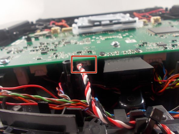

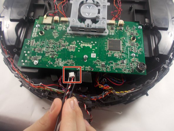

  9. iRobot Roomba 890 IR Sensor Replacement: crwdns2935265:09crwdnd2935265:01crwdnd2935265:03crwdne2935265:0 iRobot Roomba 890 IR Sensor Replacement: crwdns2935265:09crwdnd2935265:02crwdnd2935265:03crwdne2935265:0 iRobot Roomba 890 IR Sensor Replacement: crwdns2935265:09crwdnd2935265:03crwdnd2935265:03crwdne2935265:0
    $3.99
    • Use a pair of angled tweezers to firmly grip the IR sensor plug, and pull it directly backwards to release it from the motherboard.
