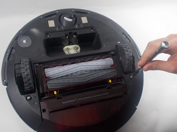

    • Use a Phillips #2 screwdriver to remove the two 11 mm screws.
    • Remove the battery cover.

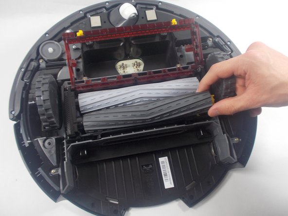

    • Use a Phillips #2 screwdriver to remove the one 7.7 mm screw.
    • Remove the yellow brush head.

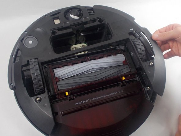

    • Lift the baseplate up and off.

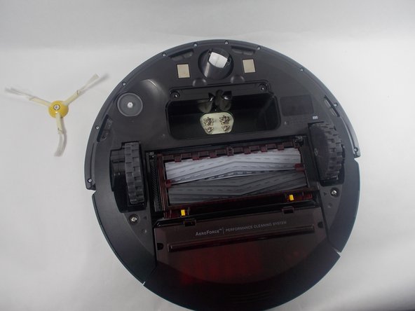

    • To remove the dust collection bin, press the release button on the top side of the Roomba and pull it straight out.

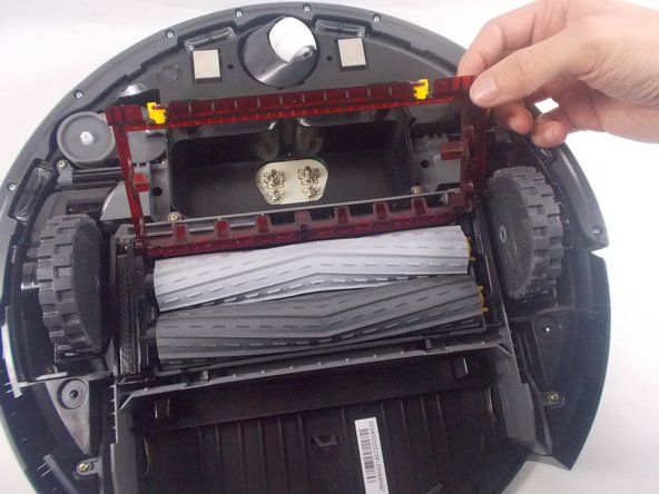

    • Press the bright yellow tabs inwards and lift up at the same time to expose the cleaning head.
    • Remove the main brushes by lifting them up and out of the housing.

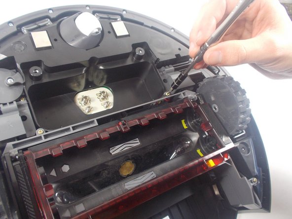

  7. iRobot Roomba 890 Cleaning Head Replacement: crwdns2935265:07crwdnd2935265:01crwdnd2935265:03crwdne2935265:0 iRobot Roomba 890 Cleaning Head Replacement: crwdns2935265:07crwdnd2935265:02crwdnd2935265:03crwdne2935265:0 iRobot Roomba 890 Cleaning Head Replacement: crwdns2935265:07crwdnd2935265:03crwdnd2935265:03crwdne2935265:0
    • Lift the cleaning head out of the Roomba.
