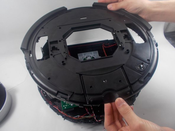

  9. iRobot Roomba 890 Bumper Sensors Replacement: crwdns2935265:09crwdnd2935265:01crwdnd2935265:03crwdne2935265:0 iRobot Roomba 890 Bumper Sensors Replacement: crwdns2935265:09crwdnd2935265:02crwdnd2935265:03crwdne2935265:0 iRobot Roomba 890 Bumper Sensors Replacement: crwdns2935265:09crwdnd2935265:03crwdnd2935265:03crwdne2935265:0
    • Use a Phillips #1 screwdriver to remove the two 9.5 mm handle screws.
    • Use a Phillips #1 screwdriver to remove the fourteen 9.5 mm top plate screws.
    • Remove the top plastic plate.

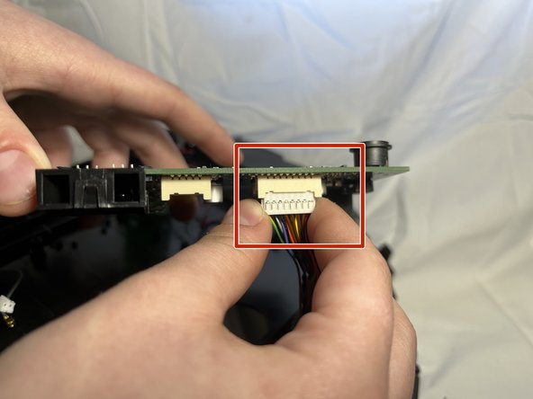

  10. iRobot Roomba 890 Bumper Sensors Replacement: crwdns2935265:010crwdnd2935265:01crwdnd2935265:02crwdne2935265:0 iRobot Roomba 890 Bumper Sensors Replacement: crwdns2935265:010crwdnd2935265:02crwdnd2935265:02crwdne2935265:0
    • Disconnect the bumper/cliff sensor harness from motherboard.
    • Do not pull on the wires; instead pull on the white connector. Sometimes it is necessary to gently "walk" the connector from side to side to loosen it. Never pull at an angle.

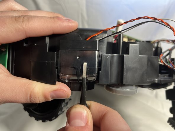

  12. iRobot Roomba 890 Bumper Sensors Replacement: crwdns2935265:012crwdnd2935265:01crwdnd2935265:02crwdne2935265:0 iRobot Roomba 890 Bumper Sensors Replacement: crwdns2935265:012crwdnd2935265:02crwdnd2935265:02crwdne2935265:0
    • Use blunt nose tweezers to remove the four cliff sensors.
    • Grip the IR sensors between the sensor and the Roomba chassis, then push on the sensors in an upward motion from the bottom of the sensor to remove them.

for step 12: just make sure to push in the IR cliff sensor towards the roomba and they should pop out really easily.
