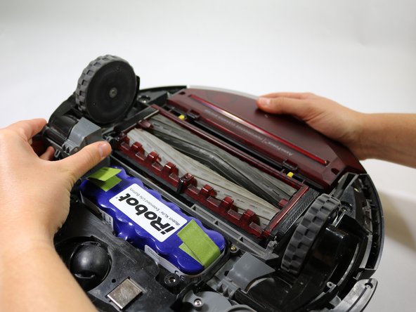

    • Start with your Roomba upside down, with the wheels facing up.
    • Using a JIS driver in #1 size remove the two 15mm screws holding the battery cover in place.
  2. iRobot Roomba 880 Side Wheels Replacement: crwdns2935265:02crwdnd2935265:01crwdnd2935265:01crwdne2935265:0
    • Remove the battery cover and place it off to the side.
  3. iRobot Roomba 880 Side Wheels Replacement: crwdns2935265:03crwdnd2935265:01crwdnd2935265:02crwdne2935265:0 iRobot Roomba 880 Side Wheels Replacement: crwdns2935265:03crwdnd2935265:02crwdnd2935265:02crwdne2935265:0
    • Remove the battery using the green tabs on either side of the battery.

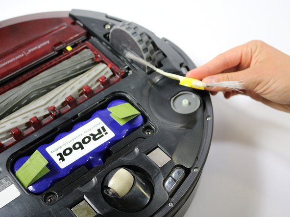

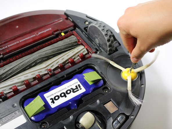

    • Loosen the side brush screw with a screwdriver.
    • Remove the side brush
  5. iRobot Roomba 880 Side Wheels Replacement: crwdns2935265:05crwdnd2935265:01crwdnd2935265:03crwdne2935265:0 iRobot Roomba 880 Side Wheels Replacement: crwdns2935265:05crwdnd2935265:02crwdnd2935265:03crwdne2935265:0 iRobot Roomba 880 Side Wheels Replacement: crwdns2935265:05crwdnd2935265:03crwdnd2935265:03crwdne2935265:0
    • Loosen the single screws that retains the side wheel to the Roomba.
    • Remove cover over the wheel that was held in place by the screws.
    • Remove the wheel module.
