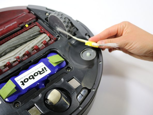

  2. iRobot Roomba 880 Side Brush Motor Replacement: crwdns2935265:02crwdnd2935265:01crwdnd2935265:03crwdne2935265:0 iRobot Roomba 880 Side Brush Motor Replacement: crwdns2935265:02crwdnd2935265:02crwdnd2935265:03crwdne2935265:0 iRobot Roomba 880 Side Brush Motor Replacement: crwdns2935265:02crwdnd2935265:03crwdnd2935265:03crwdne2935265:0
    • Remove two 15mm Phillips #1 screws beneath each side wheel.

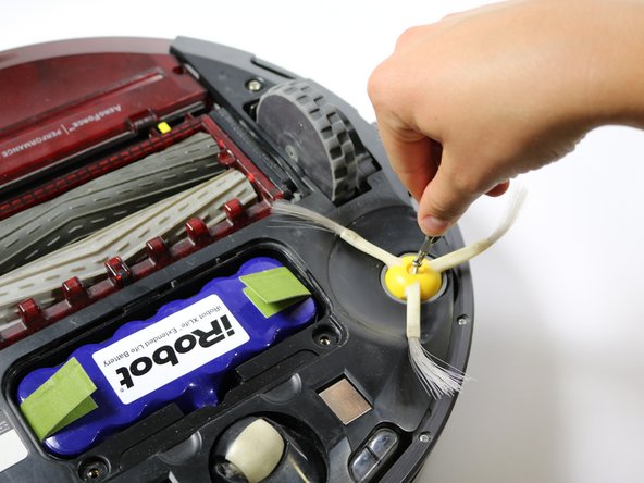

  3. iRobot Roomba 880 Side Brush Motor Replacement: crwdns2935265:03crwdnd2935265:01crwdnd2935265:03crwdne2935265:0 iRobot Roomba 880 Side Brush Motor Replacement: crwdns2935265:03crwdnd2935265:02crwdnd2935265:03crwdne2935265:0 iRobot Roomba 880 Side Brush Motor Replacement: crwdns2935265:03crwdnd2935265:03crwdnd2935265:03crwdne2935265:0
    • Remove the 10mm Phillips #1 screw holding the side brush in place.
    • Once unscrewed, remove the side brush and set aside.

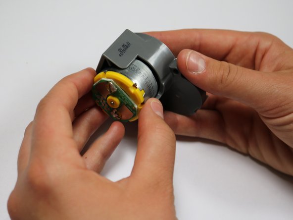

  5. iRobot Roomba 880 Side Brush Motor Replacement: crwdns2935265:05crwdnd2935265:01crwdnd2935265:02crwdne2935265:0 iRobot Roomba 880 Side Brush Motor Replacement: crwdns2935265:05crwdnd2935265:02crwdnd2935265:02crwdne2935265:0
    • Remove the three 10mm Phillips #1 screws holding down the side brush motor case.

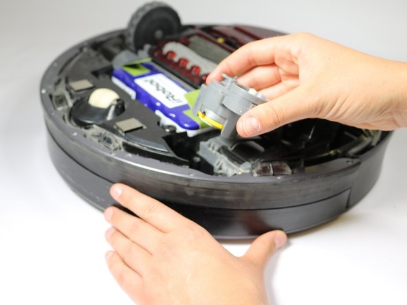

  6. iRobot Roomba 880 Side Brush Motor Replacement: crwdns2935265:06crwdnd2935265:01crwdnd2935265:02crwdne2935265:0 iRobot Roomba 880 Side Brush Motor Replacement: crwdns2935265:06crwdnd2935265:02crwdnd2935265:02crwdne2935265:0
    • Take out the side brush motor case.

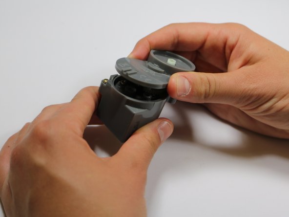

  8. iRobot Roomba 880 Side Brush Motor Replacement: crwdns2935265:08crwdnd2935265:01crwdnd2935265:03crwdne2935265:0 iRobot Roomba 880 Side Brush Motor Replacement: crwdns2935265:08crwdnd2935265:02crwdnd2935265:03crwdne2935265:0 iRobot Roomba 880 Side Brush Motor Replacement: crwdns2935265:08crwdnd2935265:03crwdnd2935265:03crwdne2935265:0
    • Remove the piece holding the lid to the case.
    • Take off the lid and set aside.

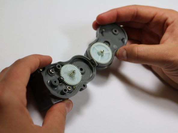

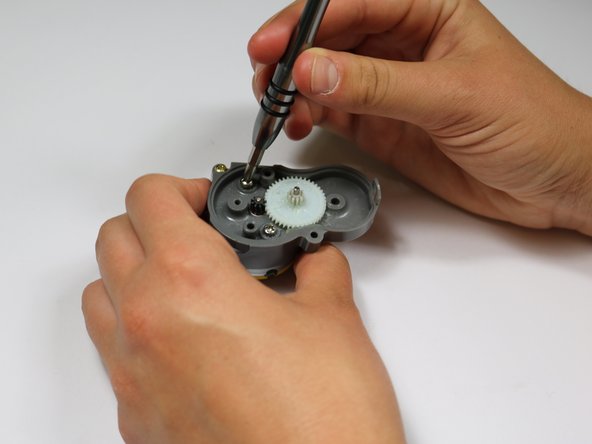

  9. iRobot Roomba 880 Side Brush Motor Replacement: crwdns2935265:09crwdnd2935265:01crwdnd2935265:02crwdne2935265:0 iRobot Roomba 880 Side Brush Motor Replacement: crwdns2935265:09crwdnd2935265:02crwdnd2935265:02crwdne2935265:0
    • Remove the three 10mm Phillips #1 screws.
  10. iRobot Roomba 880 Side Brush Motor Replacement: crwdns2935265:010crwdnd2935265:01crwdnd2935265:03crwdne2935265:0 iRobot Roomba 880 Side Brush Motor Replacement: crwdns2935265:010crwdnd2935265:02crwdnd2935265:03crwdne2935265:0 iRobot Roomba 880 Side Brush Motor Replacement: crwdns2935265:010crwdnd2935265:03crwdnd2935265:03crwdne2935265:0
    • Flip over and remove the side brush motor.
    • All done!
