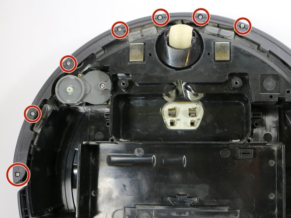

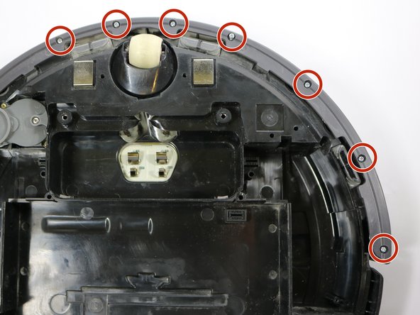

  4. iRobot Roomba 880 Bumper Sensors Replacement: crwdns2935265:04crwdnd2935265:01crwdnd2935265:03crwdne2935265:0 iRobot Roomba 880 Bumper Sensors Replacement: crwdns2935265:04crwdnd2935265:02crwdnd2935265:03crwdne2935265:0 iRobot Roomba 880 Bumper Sensors Replacement: crwdns2935265:04crwdnd2935265:03crwdnd2935265:03crwdne2935265:0
    • Using a Phillips #1 screwdriver, remove the ten 10mm screws that hold the bumper in place.

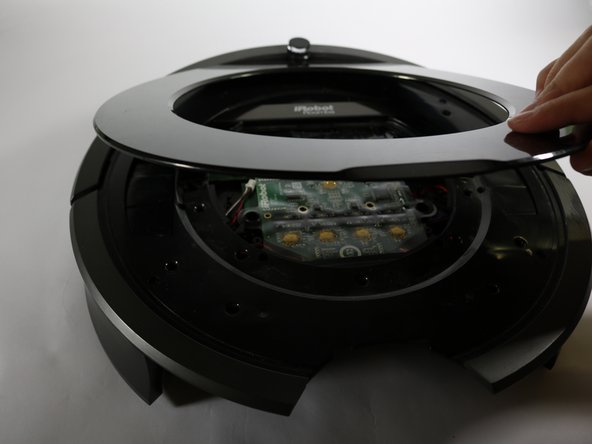

  5. iRobot Roomba 880 Bumper Sensors Replacement: crwdns2935265:05crwdnd2935265:01crwdnd2935265:01crwdne2935265:0
    • Flip your Roomba over so you are looking at the face of your device.
    • Using a plastic opening tool, pry the face plate off of the Roomba.
    • While prying the the face plate off of the Roomba, do so gently. Do not force the plate off as this could result in broken pieces.

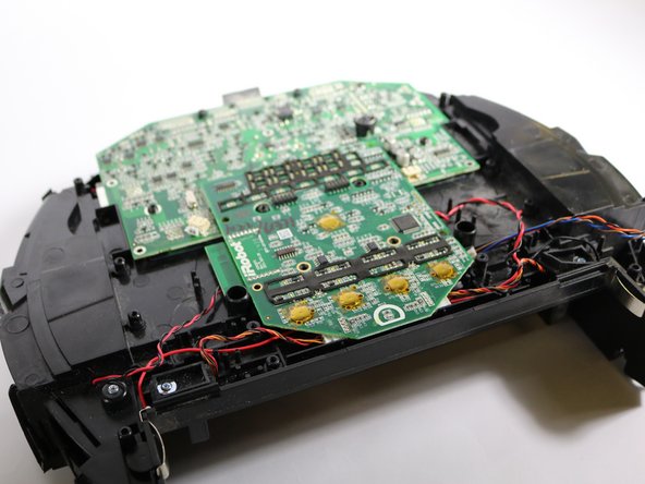

    • Using a Phillips #0 screwdriver, remove the six 10mm screws holding the black panel in place.
  8. iRobot Roomba 880 Bumper Sensors Replacement: crwdns2935265:08crwdnd2935265:01crwdnd2935265:02crwdne2935265:0 iRobot Roomba 880 Bumper Sensors Replacement: crwdns2935265:08crwdnd2935265:02crwdnd2935265:02crwdne2935265:0
    • Remove the two plastic coverings that further protect the motherboard.

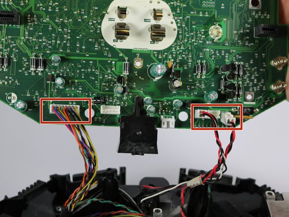

    • This next step will require some force as the cables are securely connected to the motherboard at this time.
    • Remove the two cables that connect the bumper and sensors from the motherboard.
    • As you can see in the photo, the cable and the location of where it goes on the motherboard are marked with their respective shapes.

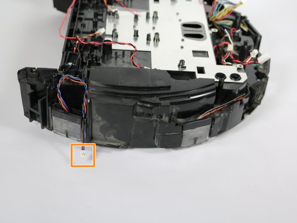

    • Fully disengage the bumper, along with the skinny IR sensor track from the main part of the device.
    • The sensor track is hidden underneath the bumper, but it connected with several wires.

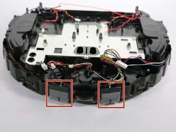

    • Remove the 6 bumper sensors from the side of your device.
    • This will require some tugging as the sensors are securely situated in the device currently. We recommend using a spudger if they are particularly difficult.
    • You might need to cut the tape that is currently holding several sets of bumper sensor wires together. It might be helpful to tape the new sensor wires back together when putting your device back together.
    • As you can see in the third photo the cable from the bumper sensor was originally connected to the motherboard.
  12. iRobot Roomba 880 Bumper Sensors Replacement: crwdns2935265:012crwdnd2935265:01crwdnd2935265:01crwdne2935265:0
    • Now you can easily snap the 6 replacement bumper sensors into the device, and begin the reassembly.
