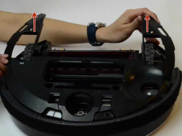

  4. iRobot Roomba 860 Side Wheel Assembly Replacement, Side Wheel Assembly: crwdns2935265:04crwdnd2935265:01crwdnd2935265:02crwdne2935265:0 iRobot Roomba 860 Side Wheel Assembly Replacement, Side Wheel Assembly: crwdns2935265:04crwdnd2935265:02crwdnd2935265:02crwdne2935265:0
    • To remove the Side Wheel Assembly, start by locating 2 15mm Phillips #2 Point screws above the wheels.
    • Remove the screws and pull up on the plate surrounding the side wheels.
    • Locate and remove 3x Phillips #0 Point Screws located behind the yellow side brush, bottom let corner of heel assembly, and on the outside of the wheel assembly.
    • With all the screws removed, lift up on the side wheel assembly to remove it from the Roomba housing.
    • The other wheel can be removed and replaced the same way
