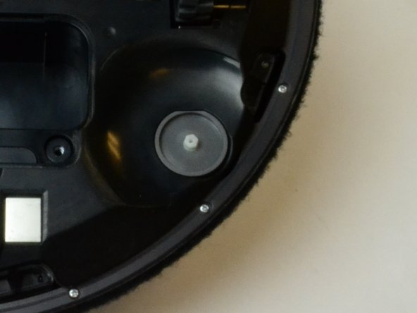

    • Start by locating the yellow side brush on the underside of the iRobot Roomba 860 near the front of the device.
  2. iRobot Roomba 860 Side Brush Replacement: crwdns2935265:02crwdnd2935265:01crwdnd2935265:01crwdne2935265:0
    • Using a Philips #2 Point Screwdriver, remove the screw located in the center of the brush.
  3. iRobot Roomba 860 Side Brush Replacement: crwdns2935265:03crwdnd2935265:01crwdnd2935265:02crwdne2935265:0 iRobot Roomba 860 Side Brush Replacement: crwdns2935265:03crwdnd2935265:02crwdnd2935265:02crwdne2935265:0
    • Pull up on the side brush and it should slide off, free of the motor shaft.
    • Remove any debris that could be preventing the side brush from spinning and/or replace the side brush.
