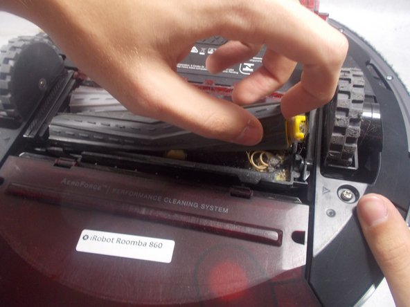

    • Flip the Roomba upside down and so that the side brush is closest to you and on the right side.
  2. iRobot Roomba 860 Main Brush Replacement: crwdns2935265:02crwdnd2935265:01crwdnd2935265:03crwdne2935265:0 iRobot Roomba 860 Main Brush Replacement: crwdns2935265:02crwdnd2935265:02crwdnd2935265:03crwdne2935265:0 iRobot Roomba 860 Main Brush Replacement: crwdns2935265:02crwdnd2935265:03crwdnd2935265:03crwdne2935265:0
    • Using the two yellow tabs, pinch them towards one another.
    • Carefully lift the door up with the hinge away from you.

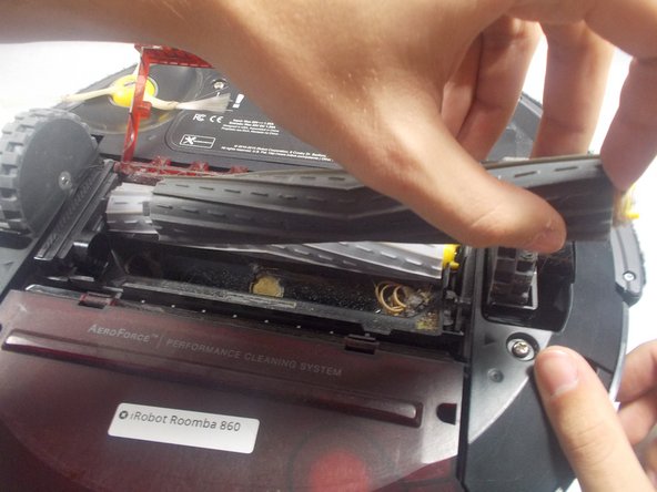

  3. iRobot Roomba 860 Main Brush Replacement: crwdns2935265:03crwdnd2935265:01crwdnd2935265:03crwdne2935265:0 iRobot Roomba 860 Main Brush Replacement: crwdns2935265:03crwdnd2935265:02crwdnd2935265:03crwdne2935265:0 iRobot Roomba 860 Main Brush Replacement: crwdns2935265:03crwdnd2935265:03crwdnd2935265:03crwdne2935265:0
    • Pull out the main brush, similar to removing a set of batteries from a remote.
    • Repeat to remove both of the main brushes.
