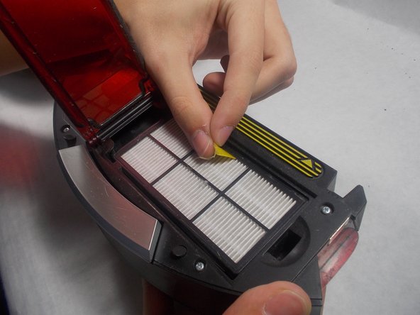

  2. iRobot Roomba 860 Filter Replacement: crwdns2935265:02crwdnd2935265:01crwdnd2935265:02crwdne2935265:0 iRobot Roomba 860 Filter Replacement: crwdns2935265:02crwdnd2935265:02crwdnd2935265:02crwdne2935265:0
    • With the dust bin completely detached from the Roomba, press the tab that is located on your right.
    • Now lift red plastic cover to begin removing the filter.

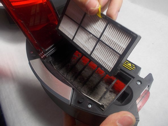

  3. iRobot Roomba 860 Filter Replacement: crwdns2935265:03crwdnd2935265:01crwdnd2935265:02crwdne2935265:0 iRobot Roomba 860 Filter Replacement: crwdns2935265:03crwdnd2935265:02crwdnd2935265:02crwdne2935265:0
    • Using the yellow ribbon that is located at the top of the filter, pull it towards you.
    • Carefully remove the used filter.
