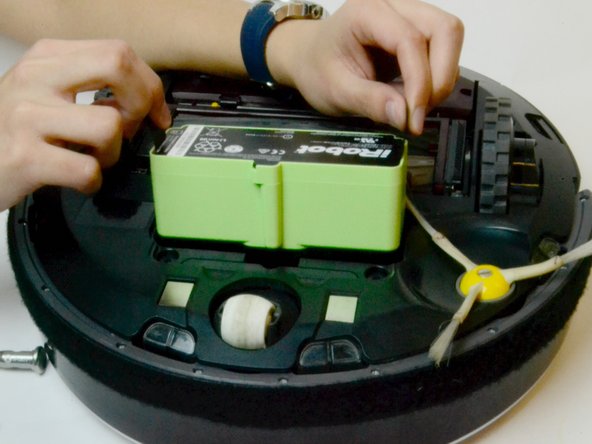

    • Start by powering down the device to remove the battery from the iRobot Roomba 860.
  2. iRobot Roomba 860 Battery Replacement: crwdns2935265:02crwdnd2935265:01crwdnd2935265:02crwdne2935265:0 iRobot Roomba 860 Battery Replacement: crwdns2935265:02crwdnd2935265:02crwdnd2935265:02crwdne2935265:0
    • Flip the Roomba over so that the underside is facing up.
    • Locate the battery panel and the 2 - 7 mm Phillips #2 Point Screws.
    • Using a Phillips #2 Point Screwdriver, remove the screws and use your fingers to pull the cover away from the device.
  3. iRobot Roomba 860 Battery Replacement: crwdns2935265:03crwdnd2935265:01crwdnd2935265:02crwdne2935265:0 iRobot Roomba 860 Battery Replacement: crwdns2935265:03crwdnd2935265:02crwdnd2935265:02crwdne2935265:0
    • Locate the two fabric tabs on the side of the battery.
    • Pull up on the tabs to easily remove the battery.
