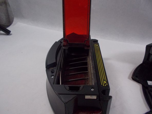

    • At the back of the Roomba, squeeze the release latch.
    • Firmly pull upwards to remove the filter bay.
  2. iRobot Roomba 805 Filter Replacement: crwdns2935265:02crwdnd2935265:01crwdnd2935265:02crwdne2935265:0 iRobot Roomba 805 Filter Replacement: crwdns2935265:02crwdnd2935265:02crwdnd2935265:02crwdne2935265:0
    • Push in the lever and pull open the filter door.
  3. iRobot Roomba 805 Filter Replacement: crwdns2935265:03crwdnd2935265:01crwdnd2935265:02crwdne2935265:0 iRobot Roomba 805 Filter Replacement: crwdns2935265:03crwdnd2935265:02crwdnd2935265:02crwdne2935265:0
    • Grab the filter by the pull tag and remove it from the filter bay.
    • Now you can clean the filter and the filter bay or replace the filter with a new one.
