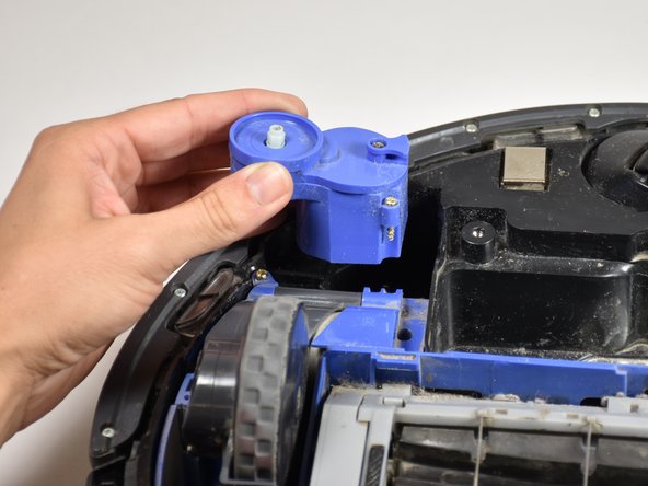

  3. iRobot Roomba 770 Side Brush Motor Replacement, Side Brush Motor: crwdns2935265:03crwdnd2935265:01crwdnd2935265:01crwdne2935265:0
    • Using the J1 Philips Screwdriver, remove the 15.5 mm screw located in the center of the side brush.
    • Remove the brush by pulling upwards.
    • Do not lean directly over the brush when attempting to remove. Removing the brush requires a firm pull and may release suddenly.
  4. iRobot Roomba 770 Side Brush Motor Replacement: crwdns2935265:04crwdnd2935265:01crwdnd2935265:02crwdne2935265:0 iRobot Roomba 770 Side Brush Motor Replacement: crwdns2935265:04crwdnd2935265:02crwdnd2935265:02crwdne2935265:0
    • Using the J1 Philips Screwdriver, remove the two 15.5 mm screws located on the bottom of the plate covering the bottom of the roomba.
    • Lift upwards to remove the bottom plate.
  5. iRobot Roomba 770 Side Brush Motor Replacement: crwdns2935265:05crwdnd2935265:01crwdnd2935265:02crwdne2935265:0 iRobot Roomba 770 Side Brush Motor Replacement: crwdns2935265:05crwdnd2935265:02crwdnd2935265:02crwdne2935265:0
    • Using the J1 Philips Screwdriver, remove the two gold 15.5 mm screws located on the blue plastic module the side brush had previously been attached too.
    • Lift the blue module upwards. The module contains the motor for the side brush.
