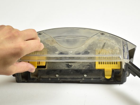

    • Orient the Roomba so that the "Clean Button" is up, and so that the words are right side up.
    • Push down on the large button on the part of the Roomba that is closest to you. Pull the back of the Roomba (the dust bin) out.
  2. iRobot Roomba 770 Filter Replacement: crwdns2935265:02crwdnd2935265:01crwdnd2935265:03crwdne2935265:0 iRobot Roomba 770 Filter Replacement: crwdns2935265:02crwdnd2935265:02crwdnd2935265:03crwdne2935265:0 iRobot Roomba 770 Filter Replacement: crwdns2935265:02crwdnd2935265:03crwdnd2935265:03crwdne2935265:0
    • Take the dust bin and orient it so that the curved part is facing away and the clear side is facing up.
    • Push the small yellow tab inward, and swing it out toward you.
  3. iRobot Roomba 770 Filter Replacement: crwdns2935265:03crwdnd2935265:01crwdnd2935265:02crwdne2935265:0 iRobot Roomba 770 Filter Replacement: crwdns2935265:03crwdnd2935265:02crwdnd2935265:02crwdne2935265:0
    • Push up on the yellow tabs on the yellow filters, and pull both filters out.
