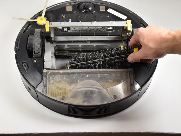

    • Orient the roomba so it is upside down and the dust tray is closest to you.
  2. iRobot Roomba 770 Brush Replacement: crwdns2935265:02crwdnd2935265:01crwdnd2935265:02crwdne2935265:0 iRobot Roomba 770 Brush Replacement: crwdns2935265:02crwdnd2935265:02crwdnd2935265:02crwdne2935265:0
    • Locate the two yellow tabs on the screen that covers the brushes.
    • Push inwards on the yellow tabs while simultaneously pulling upwards on the attached grey cage.

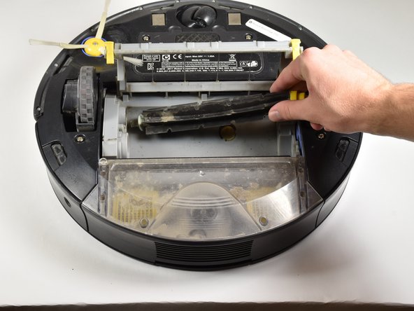

  3. iRobot Roomba 770 Brush Replacement: crwdns2935265:03crwdnd2935265:01crwdnd2935265:03crwdne2935265:0 iRobot Roomba 770 Brush Replacement: crwdns2935265:03crwdnd2935265:02crwdnd2935265:03crwdne2935265:0 iRobot Roomba 770 Brush Replacement: crwdns2935265:03crwdnd2935265:03crwdnd2935265:03crwdne2935265:0
    • Grab the right side of the larger brush that is located near the yellow cap. Pull upwards and to the right to remove the brush.
    • Repeat the same steps with the smaller brush.

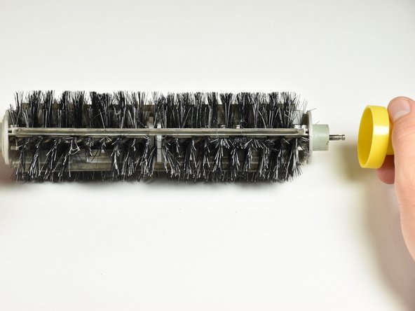

  4. iRobot Roomba 770 Brush Replacement: crwdns2935265:04crwdnd2935265:01crwdnd2935265:02crwdne2935265:0 iRobot Roomba 770 Brush Replacement: crwdns2935265:04crwdnd2935265:02crwdnd2935265:02crwdne2935265:0
    • Orient the brush so the yellow tab is on the right hand side.
    • Pull the yellow tab to the right to remove.
    • Remove any debris, paying attention to the ends as well as the brush itself.
    • Replace any damaged brushes.
