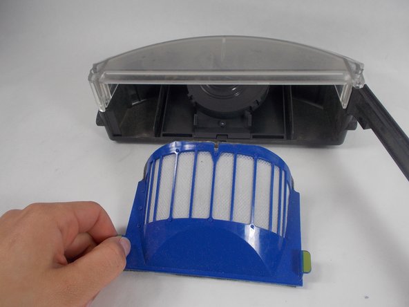

    • Press the button on the face of the Roomba to release the bin. Pull out the bin.
  2. iRobot Roomba 694 Filter Replacement: crwdns2935265:02crwdnd2935265:01crwdnd2935265:02crwdne2935265:0 iRobot Roomba 694 Filter Replacement: crwdns2935265:02crwdnd2935265:02crwdnd2935265:02crwdne2935265:0
    • Empty out the bin.
  3. iRobot Roomba 694 Filter Replacement: crwdns2935265:03crwdnd2935265:01crwdnd2935265:02crwdne2935265:0 iRobot Roomba 694 Filter Replacement: crwdns2935265:03crwdnd2935265:02crwdnd2935265:02crwdne2935265:0
    • Remove the filter from the Roomba by sliding it out of the bin.
    • If the filter is in good condition, you can clean it and reuse it. If it is damaged or unable to be cleaned sufficiently, replace the filter with a new one.
