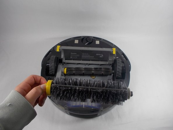

    • Place the Roomba upside down.
  2. iRobot Roomba 694 Brush Replacement: crwdns2935265:02crwdnd2935265:01crwdnd2935265:01crwdne2935265:0
    • Press down on the yellow tabs and gently lift them upwards to open up the guard.
  3. iRobot Roomba 694 Brush Replacement: crwdns2935265:03crwdnd2935265:01crwdnd2935265:02crwdne2935265:0 iRobot Roomba 694 Brush Replacement: crwdns2935265:03crwdnd2935265:02crwdnd2935265:02crwdne2935265:0
    • Hold onto the bristles near the yellow side of the brushes, lifting the yellow piece out and sliding the brush out.
