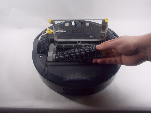

    • Place the Roomba upside down so that the wheels and brushes are facing upward.
  2. iRobot Roomba 690 Roller Brushes Replacement: crwdns2935265:02crwdnd2935265:01crwdnd2935265:03crwdne2935265:0 iRobot Roomba 690 Roller Brushes Replacement: crwdns2935265:02crwdnd2935265:02crwdnd2935265:03crwdne2935265:0 iRobot Roomba 690 Roller Brushes Replacement: crwdns2935265:02crwdnd2935265:03crwdnd2935265:03crwdne2935265:0
    • In the middle of the Roomba, push the two yellow switches apart to lift open the latch.
  3. iRobot Roomba 690 Roller Brushes Replacement: crwdns2935265:03crwdnd2935265:01crwdnd2935265:03crwdne2935265:0 iRobot Roomba 690 Roller Brushes Replacement: crwdns2935265:03crwdnd2935265:02crwdnd2935265:03crwdne2935265:0 iRobot Roomba 690 Roller Brushes Replacement: crwdns2935265:03crwdnd2935265:03crwdnd2935265:03crwdne2935265:0

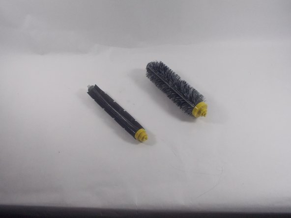

    • Lift the two brushes from the yellow end, and pull away from the gray end to remove from the vacuum.
