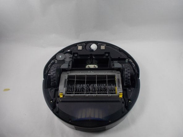

    • Place the Roomba upside down so that the wheels and brushes are facing upward.
  2. iRobot Roomba 690 Drive Wheels Replacement: crwdns2935265:02crwdnd2935265:01crwdnd2935265:03crwdne2935265:0 iRobot Roomba 690 Drive Wheels Replacement: crwdns2935265:02crwdnd2935265:02crwdnd2935265:03crwdne2935265:0 iRobot Roomba 690 Drive Wheels Replacement: crwdns2935265:02crwdnd2935265:03crwdnd2935265:03crwdne2935265:0
    • Loosen the captive screw in the spinning brush using a Phillips #0 screwdriver.
    • Remove the spinning brush from the vacuum.

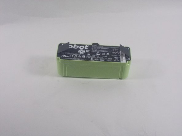

  3. iRobot Roomba 690 Drive Wheels Replacement, Battery: crwdns2935265:03crwdnd2935265:01crwdnd2935265:01crwdne2935265:0
    • Remove the four 6.4 mm screws from the bottom of the Roomba using a Phillips #0 screwdriver.
    • They are labeled with triangular arrows next to them on the cover.
  4. iRobot Roomba 690 Drive Wheels Replacement: crwdns2935265:04crwdnd2935265:01crwdnd2935265:01crwdne2935265:0
    • Lift the bottom cover up from the rest of the Roomba.
  5. iRobot Roomba 690 Drive Wheels Replacement: crwdns2935265:05crwdnd2935265:01crwdnd2935265:03crwdne2935265:0 iRobot Roomba 690 Drive Wheels Replacement: crwdns2935265:05crwdnd2935265:02crwdnd2935265:03crwdne2935265:0 iRobot Roomba 690 Drive Wheels Replacement: crwdns2935265:05crwdnd2935265:03crwdnd2935265:03crwdne2935265:0
    • Lift out the battery by pulling up on the two flexible tabs that are attached to the left and right sides.

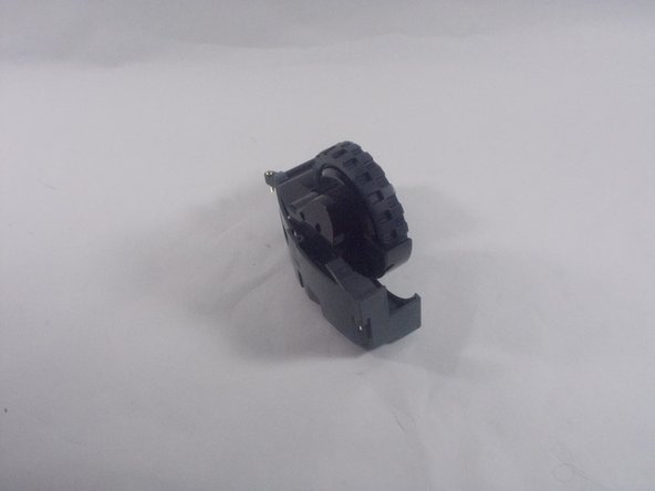

  6. iRobot Roomba 690 Drive Wheels Replacement, Drive Wheels: crwdns2935265:06crwdnd2935265:01crwdnd2935265:02crwdne2935265:0 iRobot Roomba 690 Drive Wheels Replacement, Drive Wheels: crwdns2935265:06crwdnd2935265:02crwdnd2935265:02crwdne2935265:0
    • Each drive wheel is labeled left and right.
    • Remove three 12 mm screws from each drive wheel using a Phillips #0 screwdriver.
    • Remove the drive wheels from the vacuum.
