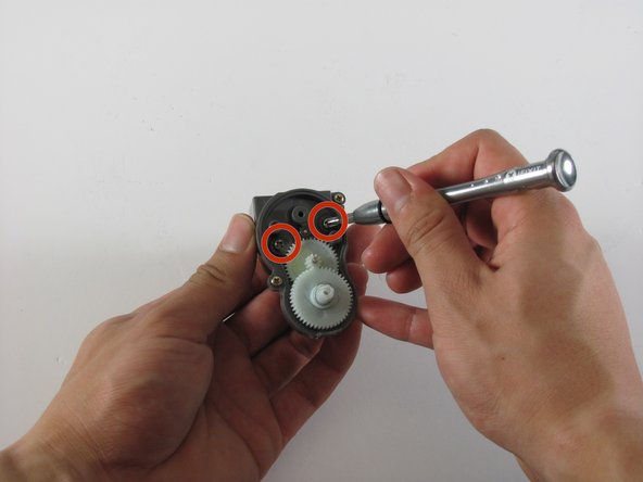

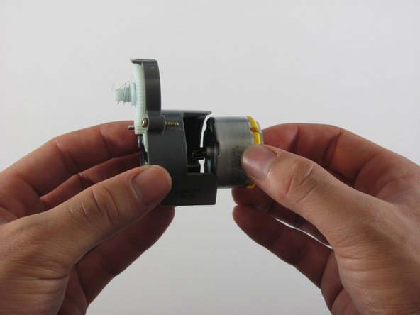

  3. iRobot Roomba 655 Pet Series Side Brush Motor Replacement, Motor Removal: crwdns2935265:03crwdnd2935265:01crwdnd2935265:03crwdne2935265:0 iRobot Roomba 655 Pet Series Side Brush Motor Replacement, Motor Removal: crwdns2935265:03crwdnd2935265:02crwdnd2935265:03crwdne2935265:0 iRobot Roomba 655 Pet Series Side Brush Motor Replacement, Motor Removal: crwdns2935265:03crwdnd2935265:03crwdnd2935265:03crwdne2935265:0
    • Removing these two screws will allow you to access the motor (use the same head as before)
