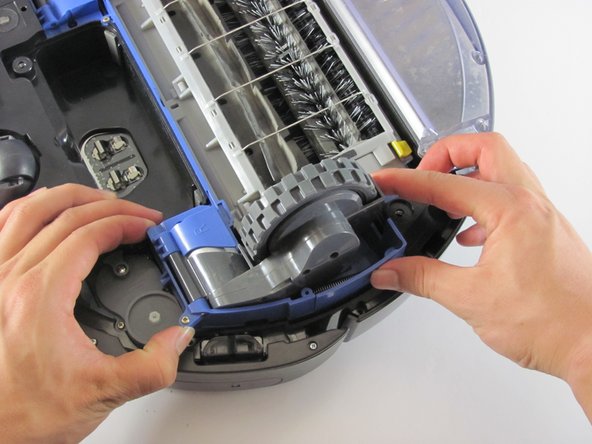

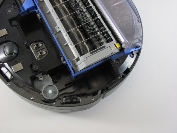

  5. iRobot Roomba 655 Pet Series Drive Wheels Replacement, Drive Wheels: crwdns2935265:05crwdnd2935265:01crwdnd2935265:03crwdne2935265:0 iRobot Roomba 655 Pet Series Drive Wheels Replacement, Drive Wheels: crwdns2935265:05crwdnd2935265:02crwdnd2935265:03crwdne2935265:0 iRobot Roomba 655 Pet Series Drive Wheels Replacement, Drive Wheels: crwdns2935265:05crwdnd2935265:03crwdnd2935265:03crwdne2935265:0
    • Remove the three screws with your Phillips head #1, holding the drive wheels in place
    • These three screws will stay in place and won't come out of the plastic

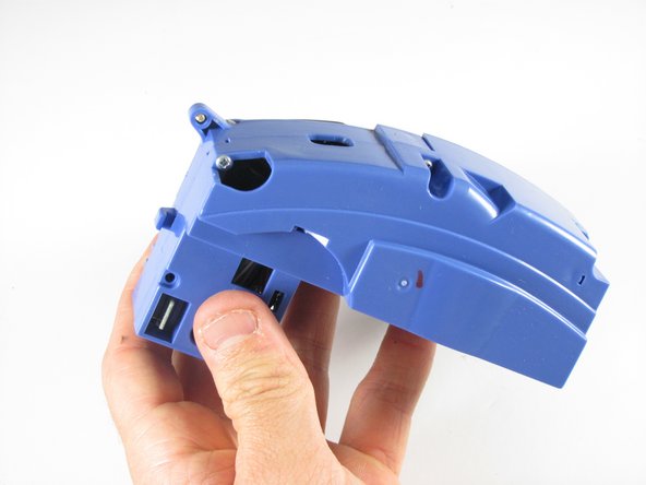

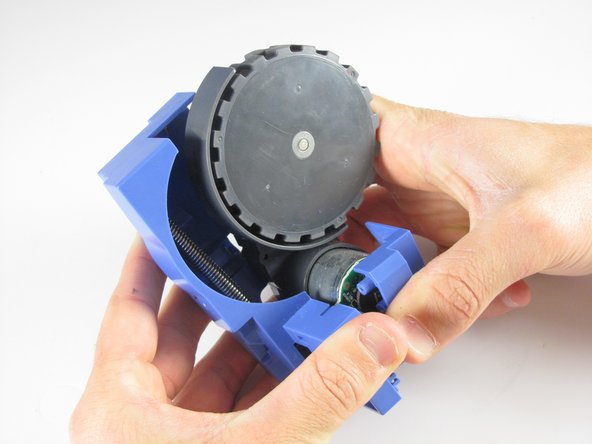

  6. iRobot Roomba 655 Pet Series Drive Wheels Replacement: crwdns2935265:06crwdnd2935265:01crwdnd2935265:03crwdne2935265:0 iRobot Roomba 655 Pet Series Drive Wheels Replacement: crwdns2935265:06crwdnd2935265:02crwdnd2935265:03crwdne2935265:0 iRobot Roomba 655 Pet Series Drive Wheels Replacement: crwdns2935265:06crwdnd2935265:03crwdnd2935265:03crwdne2935265:0
    • Unscrew the actual wheel from the blue plastic holder
    • Pull apart the blue holder to completely remove the wheel

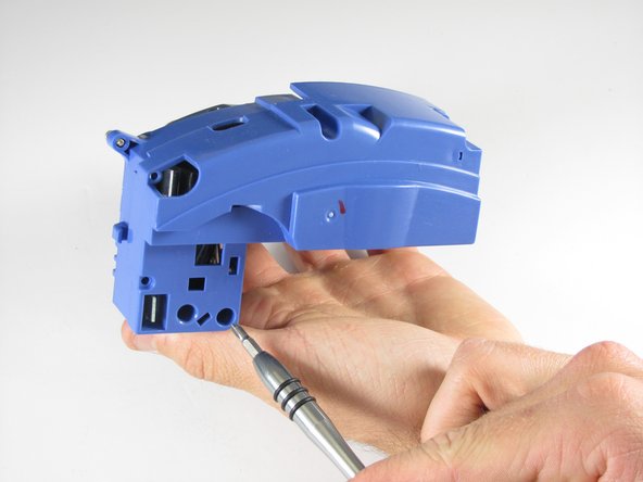

  7. iRobot Roomba 655 Pet Series Drive Wheels Replacement: crwdns2935265:07crwdnd2935265:01crwdnd2935265:02crwdne2935265:0 iRobot Roomba 655 Pet Series Drive Wheels Replacement: crwdns2935265:07crwdnd2935265:02crwdnd2935265:02crwdne2935265:0
    • To go further into the holder to access the programming chips you can unscrew these compartments
