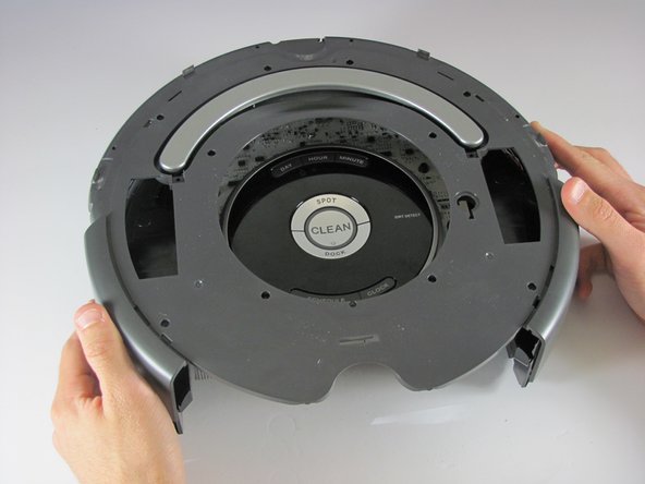

    • Pull up on the silver handle to release the top protectant plastic
    • Remove the top plastic carefully

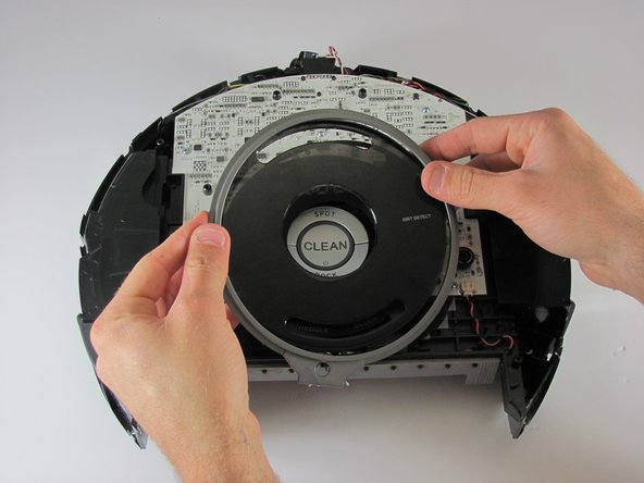

  9. iRobot Roomba 655 Pet Series Cliff Sensors Replacement, Internal Faceplate: crwdns2935265:09crwdnd2935265:01crwdnd2935265:03crwdne2935265:0 iRobot Roomba 655 Pet Series Cliff Sensors Replacement, Internal Faceplate: crwdns2935265:09crwdnd2935265:02crwdnd2935265:03crwdne2935265:0 iRobot Roomba 655 Pet Series Cliff Sensors Replacement, Internal Faceplate: crwdns2935265:09crwdnd2935265:03crwdnd2935265:03crwdne2935265:0
    • The outside six - 10mm screws and the inside set of four - 10mm screws are the same here, use your Phillips head #2 to remove them
    • Use your Phillips head #0 to remove the one - 7mm bottom center screw
    • Use your Phillips head #2 to remove the two - 8mm screws by the handle
    • Push down the two release points to pull the plastic piece up
    • Pull the plastic piece up

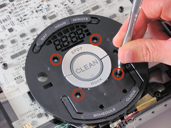

  10. iRobot Roomba 655 Pet Series Cliff Sensors Replacement, Display: crwdns2935265:010crwdnd2935265:01crwdnd2935265:03crwdne2935265:0 iRobot Roomba 655 Pet Series Cliff Sensors Replacement, Display: crwdns2935265:010crwdnd2935265:02crwdnd2935265:03crwdne2935265:0 iRobot Roomba 655 Pet Series Cliff Sensors Replacement, Display: crwdns2935265:010crwdnd2935265:03crwdnd2935265:03crwdne2935265:0
    • Pull the silver tab, and clear tinted display off
    • Remove the 4 - 9mm screws holding the display with your Phillips head #0

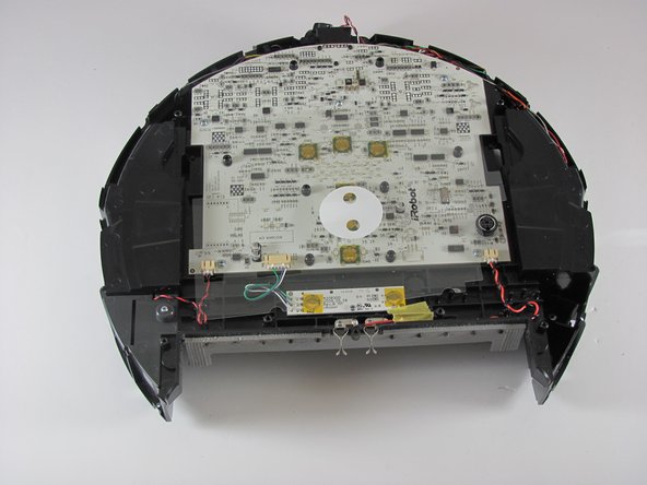

  11. iRobot Roomba 655 Pet Series Cliff Sensors Replacement: crwdns2935265:011crwdnd2935265:01crwdnd2935265:03crwdne2935265:0 iRobot Roomba 655 Pet Series Cliff Sensors Replacement: crwdns2935265:011crwdnd2935265:02crwdnd2935265:03crwdne2935265:0 iRobot Roomba 655 Pet Series Cliff Sensors Replacement: crwdns2935265:011crwdnd2935265:03crwdnd2935265:03crwdne2935265:0
    • Remove the display
    • Remove the plastic protectant film from the motherboard
  12. iRobot Roomba 655 Pet Series Cliff Sensors Replacement, Removing the Motherboard: crwdns2935265:012crwdnd2935265:01crwdnd2935265:02crwdne2935265:0 iRobot Roomba 655 Pet Series Cliff Sensors Replacement, Removing the Motherboard: crwdns2935265:012crwdnd2935265:02crwdnd2935265:02crwdne2935265:0
    • Remove the five - 8mm screws with your Phillips head #1, holding the mother board in place to the Roomba
    • Pull the mother board up off the Roomba
    • Be careful not to pull hard because there are a lot of wires attached to the motherboard

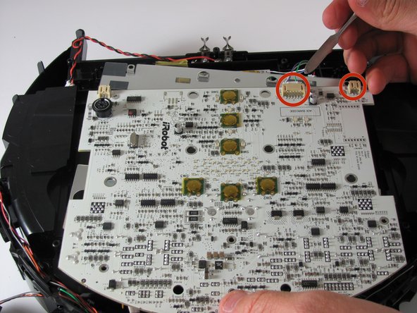

  13. iRobot Roomba 655 Pet Series Cliff Sensors Replacement, Unclipping the Wires: crwdns2935265:013crwdnd2935265:01crwdnd2935265:03crwdne2935265:0 iRobot Roomba 655 Pet Series Cliff Sensors Replacement, Unclipping the Wires: crwdns2935265:013crwdnd2935265:02crwdnd2935265:03crwdne2935265:0 iRobot Roomba 655 Pet Series Cliff Sensors Replacement, Unclipping the Wires: crwdns2935265:013crwdnd2935265:03crwdnd2935265:03crwdne2935265:0
    • Remove the three sets of wires plugged into the back of the motherboard
    • Some of these can be difficult to remove, and you may need the help of the metal spudger

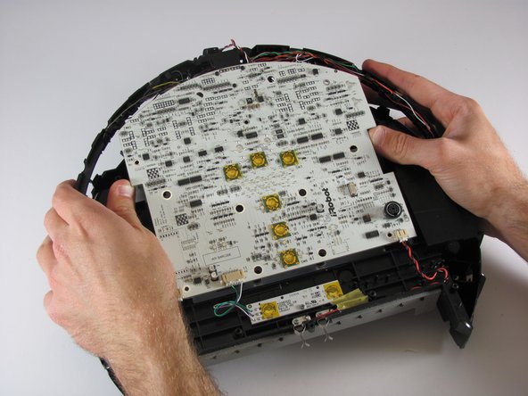

  14. iRobot Roomba 655 Pet Series Cliff Sensors Replacement, Unclip the Cliff Sensor Wires: crwdns2935265:014crwdnd2935265:01crwdnd2935265:03crwdne2935265:0 iRobot Roomba 655 Pet Series Cliff Sensors Replacement, Unclip the Cliff Sensor Wires: crwdns2935265:014crwdnd2935265:02crwdnd2935265:03crwdne2935265:0 iRobot Roomba 655 Pet Series Cliff Sensors Replacement, Unclip the Cliff Sensor Wires: crwdns2935265:014crwdnd2935265:03crwdnd2935265:03crwdne2935265:0
    • Flip the motherboard over
    • Remove the five wire connections using the same method as the previous two
    • Lastly, remove the bumper sensor wires from the motherboard

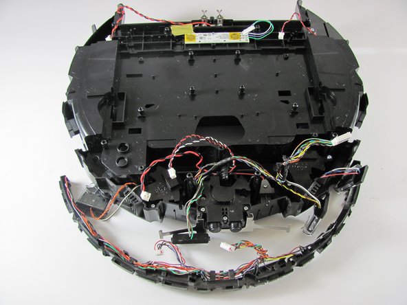

  16. iRobot Roomba 655 Pet Series Cliff Sensors Replacement: crwdns2935265:016crwdnd2935265:01crwdnd2935265:02crwdne2935265:0 iRobot Roomba 655 Pet Series Cliff Sensors Replacement: crwdns2935265:016crwdnd2935265:02crwdnd2935265:02crwdne2935265:0
    • Here are two pictures that should show what your Roomba fully disassembled looks like
