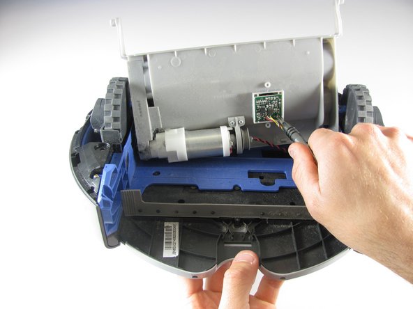

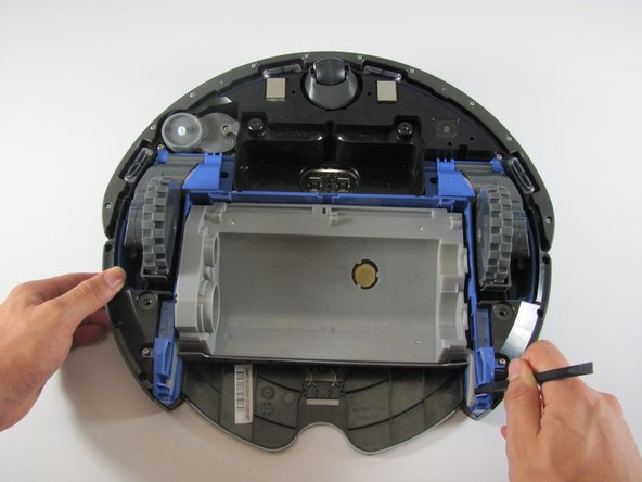

  5. iRobot Roomba 655 Pet Series Brush Motor Replacement, Brush Motor Removal: crwdns2935265:05crwdnd2935265:01crwdnd2935265:03crwdne2935265:0 iRobot Roomba 655 Pet Series Brush Motor Replacement, Brush Motor Removal: crwdns2935265:05crwdnd2935265:02crwdnd2935265:03crwdne2935265:0 iRobot Roomba 655 Pet Series Brush Motor Replacement, Brush Motor Removal: crwdns2935265:05crwdnd2935265:03crwdnd2935265:03crwdne2935265:0

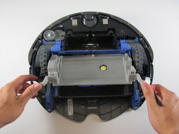

    • Insert a spudger into the side to pop out one side of the brush holder.
    • Repeat the same step, but now on the other side of the brush holder.
    • Lift the gray plastic piece up carefully to expose the motor.
    • Do not pull up too hard because you could snap a wire attached to the motor or motor circuit board.

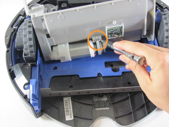

  6. iRobot Roomba 655 Pet Series Brush Motor Replacement: crwdns2935265:06crwdnd2935265:01crwdnd2935265:02crwdne2935265:0 iRobot Roomba 655 Pet Series Brush Motor Replacement: crwdns2935265:06crwdnd2935265:02crwdnd2935265:02crwdne2935265:0
    • Use a Phillips #0 to remove the two 6 mm screws securing the green circuit board protector.
    • Remove the 6mm Phillips screw attaching the circuit board. Doing so should give you access to the circuit board.

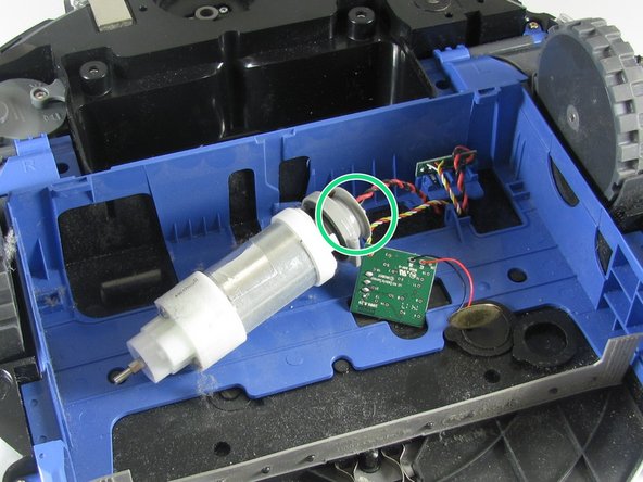

    • These rubber rings protect the motor circuit board from dust accumulated in the Roomba.
    • Do not lose these rubber rings.
    • Remove the two - 7mm screws that connect the motor to the grey plastic protector. Use a Phillips head #0 this time.

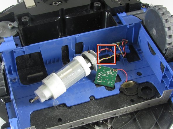

    • Option A: Some motors can unclip from the wiring harness. Use the spudger to pry the white colored base of the motor from the gray piece on the end.
    • Clip the new motor into the gray plastic in the same configuration you removed the original motor.

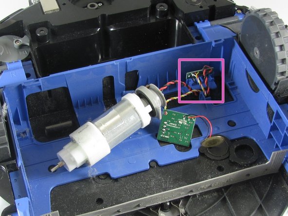

    • Option B: If your replacement motor does not have wires pre-attached, snip the existing wires near the base of the motor.
    • Solder the snipped wires to the base of the new motor in the same configuration they were with the original motor.
    • Option C: If your new motor has wires pre-attached, splice the original wires with the respective wires from the original motor.
