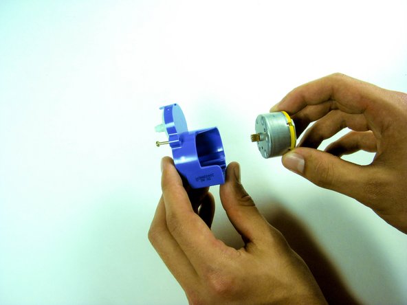

  5. iRobot Roomba 650 Side Brush Motor Replacement, Motor Removal: crwdns2935265:05crwdnd2935265:01crwdnd2935265:02crwdne2935265:0 iRobot Roomba 650 Side Brush Motor Replacement, Motor Removal: crwdns2935265:05crwdnd2935265:02crwdnd2935265:02crwdne2935265:0
    • Locate and loosen the two screws inside the gearbox with the Phillips 00 Screwdriver. The motor should come right out the bottom.

In step 4, the screw on top of the housing has an unusual head. It's similar to a Phillips screw, but it only has 3 grooves. A small flat blade screw driver can unscrew it.
When you pry off the cover of the gear box, some gears may pop out, so do this on a work surface where they won't get lost.
You may find that the brush has stopped rotating because the inside of the gear box is full of lint.
