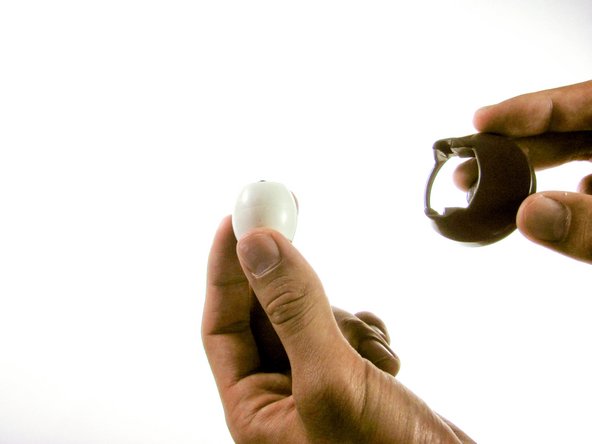

    1. iRobot Roomba 650 Caster Wheel Replacement, Caster Wheel: crwdns2935265:03crwdnd2935265:01crwdnd2935265:01crwdne2935265:0
      • Begin by pulling on the caster wheel. It should pop out of its housing fairly easily.
    2. iRobot Roomba 650 Caster Wheel Replacement: crwdns2935265:04crwdnd2935265:01crwdnd2935265:02crwdne2935265:0 iRobot Roomba 650 Caster Wheel Replacement: crwdns2935265:04crwdnd2935265:02crwdnd2935265:02crwdne2935265:0
      • Once caster wheel is off the Roomba, push on the wheel so that it slides out of the groves it sits in.

Alternate instructions.
1. skip steps 1 and 2. you don't need to take the panel off to remove the caster wheel.
2. follow steps 3 and 4.
Matt Johnson - crwdns2934203:0crwdne2934203:0 crwdns2950251:0crwdne2950251:0
Hi, my caster wheel drops out easiy from the groves… a bit like the groves are worn out already and are no longer able to hold the wheel metal spoke in place. I would like to know if this can be fixed without resorting to buying a new wheel? (Reduce, Reuse, Recycle) Please help?
