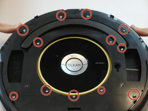

    • Unscrew the (4) four back plate screws using the Phillips #2 screwdriver.
    • Lift the back plate off of the device.

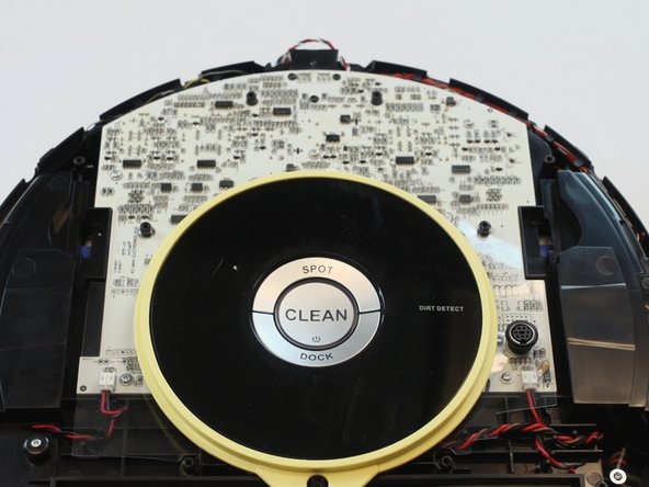

    • Flip Roomba back over and pry the top cover off.
    • Unscrew the screws to the top plate and lift off.

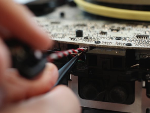

  8. iRobot Roomba 630 Top Bumper Infrared Sensor Replacement: crwdns2935265:08crwdnd2935265:01crwdnd2935265:03crwdne2935265:0 iRobot Roomba 630 Top Bumper Infrared Sensor Replacement: crwdns2935265:08crwdnd2935265:02crwdnd2935265:03crwdne2935265:0 iRobot Roomba 630 Top Bumper Infrared Sensor Replacement: crwdns2935265:08crwdnd2935265:03crwdnd2935265:03crwdne2935265:0

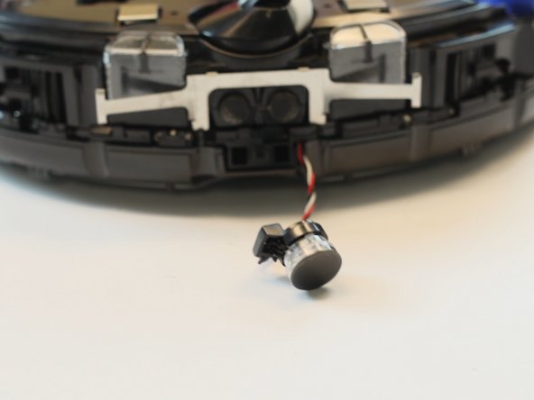

    • Use tweezers or another tool to push up on the insert while gently pulling the sensor out by its wires.
    • Remove the sensor.

Outstanding! I would only add to note position of the 12 top plate screws as they are removed since 3 are smaller/shorter (although not noticeably so) and need to be returned to their exact location. I would not call this difficult. Simply tedious. Thank you very much for the instrucitons.

Thanks for this. Roomba wanted me to send my unit in for repairs costing $130. I bought a replacement Rcon at eBay for $10. Turned out, as others have posted, the red wire was broken! That’s on Roomba!! Works like new, will repair the red wire, and save the rcon for future use.
