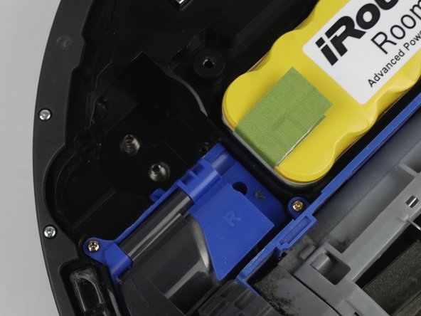

  2. iRobot Roomba 630 Side Brush Motor Replacement: crwdns2935265:02crwdnd2935265:01crwdnd2935265:02crwdne2935265:0 iRobot Roomba 630 Side Brush Motor Replacement: crwdns2935265:02crwdnd2935265:02crwdnd2935265:02crwdne2935265:0
    • Remove the four 10.1 mm screws from the back cover using a Phillips #2 screwdriver.
    • Lift the back cover off to access the gear box.

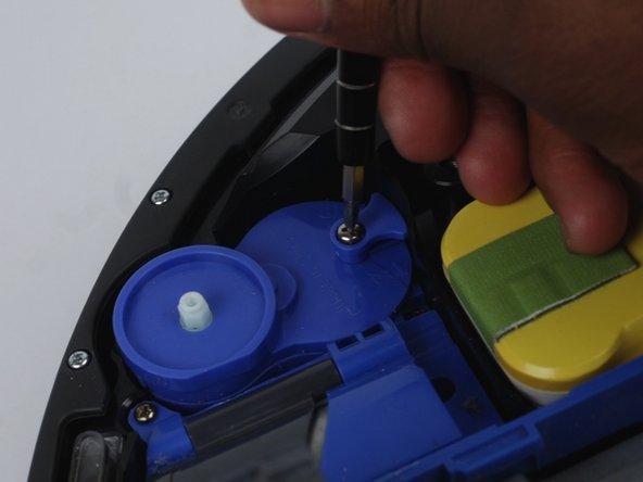

  3. iRobot Roomba 630 Side Brush Motor Replacement: crwdns2935265:03crwdnd2935265:01crwdnd2935265:03crwdne2935265:0 iRobot Roomba 630 Side Brush Motor Replacement: crwdns2935265:03crwdnd2935265:02crwdnd2935265:03crwdne2935265:0 iRobot Roomba 630 Side Brush Motor Replacement: crwdns2935265:03crwdnd2935265:03crwdnd2935265:03crwdne2935265:0
    • Remove the three outer 15 mm screws that hold down the gearbox using a Phillips #2 screwdriver.
    • Remove the middle 15 mm screw to release the gearbox using a tri-point Y0 screwdriver.
    • Lift the blue side brush gear box out.

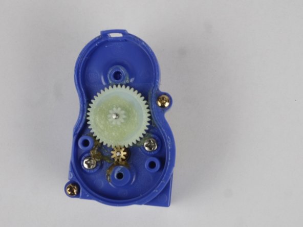

  4. iRobot Roomba 630 Side Brush Motor Replacement: crwdns2935265:04crwdnd2935265:01crwdnd2935265:02crwdne2935265:0 iRobot Roomba 630 Side Brush Motor Replacement: crwdns2935265:04crwdnd2935265:02crwdnd2935265:02crwdne2935265:0
    • Pry the top of the gear box off.
    • Check for debris in the gear box and clean it out if needed.

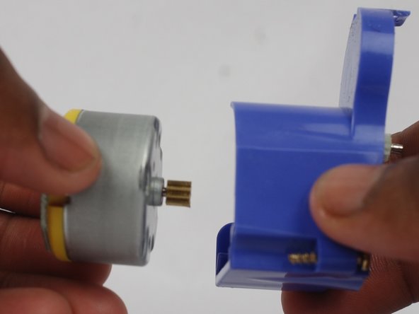

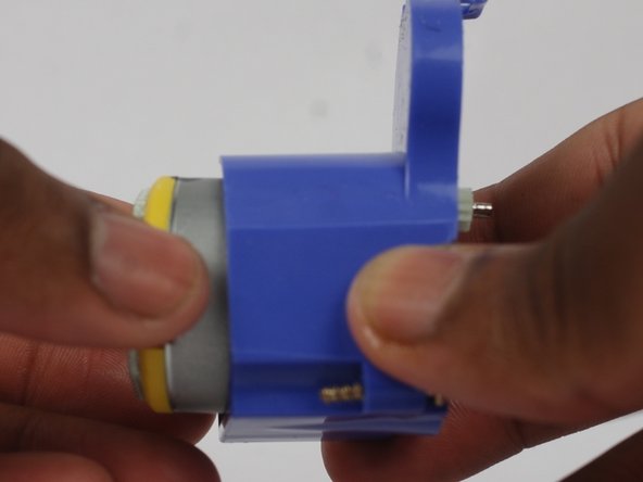

  5. iRobot Roomba 630 Side Brush Motor Replacement: crwdns2935265:05crwdnd2935265:01crwdnd2935265:03crwdne2935265:0 iRobot Roomba 630 Side Brush Motor Replacement: crwdns2935265:05crwdnd2935265:02crwdnd2935265:03crwdne2935265:0 iRobot Roomba 630 Side Brush Motor Replacement: crwdns2935265:05crwdnd2935265:03crwdnd2935265:03crwdne2935265:0
    • Remove the screws holding the motor in place using a Phillips #2 screwdriver.
    • Pull the old motor out.
