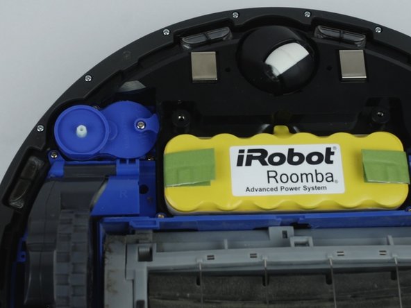

    • Press the bin button and pull the bin out.
  2. iRobot Roomba 630 Left and Right Wheels Replacement: crwdns2935265:02crwdnd2935265:01crwdnd2935265:02crwdne2935265:0 iRobot Roomba 630 Left and Right Wheels Replacement: crwdns2935265:02crwdnd2935265:02crwdnd2935265:02crwdne2935265:0

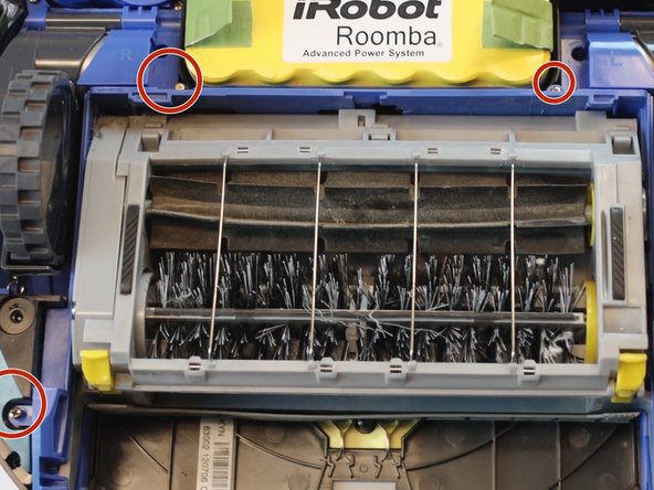

    • Flip the Roomba over and unscrew the side brush screw using the Phillips #2 screwdriver.
  3. iRobot Roomba 630 Left and Right Wheels Replacement: crwdns2935265:03crwdnd2935265:01crwdnd2935265:02crwdne2935265:0 iRobot Roomba 630 Left and Right Wheels Replacement: crwdns2935265:03crwdnd2935265:02crwdnd2935265:02crwdne2935265:0

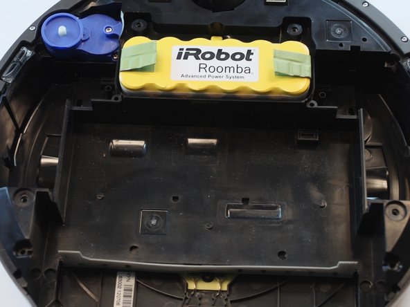

    • Unscrew the (4) four screws to the back plate and lift off.
  4. iRobot Roomba 630 Left and Right Wheels Replacement: crwdns2935265:04crwdnd2935265:01crwdnd2935265:03crwdne2935265:0 iRobot Roomba 630 Left and Right Wheels Replacement: crwdns2935265:04crwdnd2935265:02crwdnd2935265:03crwdne2935265:0 iRobot Roomba 630 Left and Right Wheels Replacement: crwdns2935265:04crwdnd2935265:03crwdnd2935265:03crwdne2935265:0

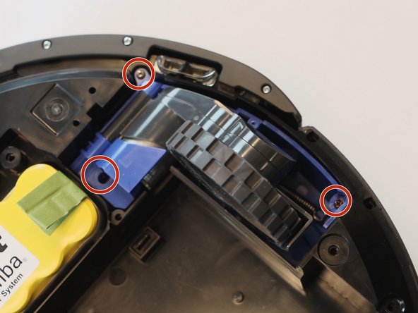

    • Unscrew the (4) four screws to the brush cage.
    • Lift the brush cage out.

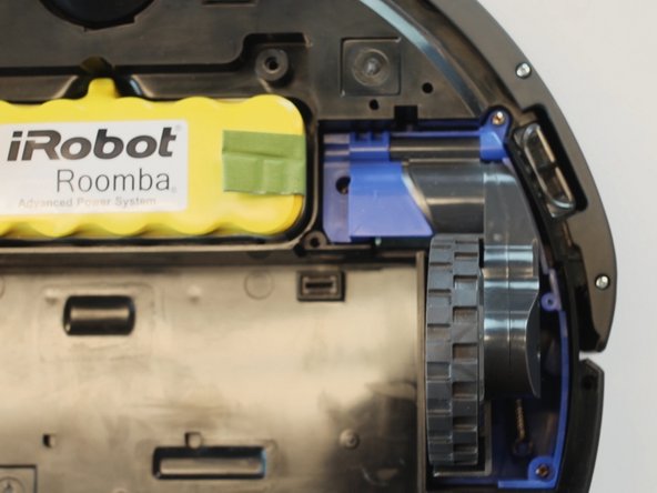

  5. iRobot Roomba 630 Left and Right Wheels Replacement: crwdns2935265:05crwdnd2935265:01crwdnd2935265:03crwdne2935265:0 iRobot Roomba 630 Left and Right Wheels Replacement: crwdns2935265:05crwdnd2935265:02crwdnd2935265:03crwdne2935265:0 iRobot Roomba 630 Left and Right Wheels Replacement: crwdns2935265:05crwdnd2935265:03crwdnd2935265:03crwdne2935265:0
    • Unscrew the (3) screws to the left wheel and the right wheel.
    • Lift the wheels out and remove them from the device.

Thank you :D My roomba is cleaning again :D
