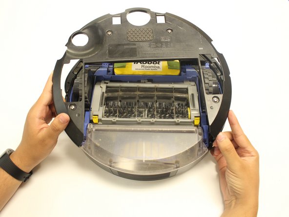

    • Unscrew the four 10mm screws on the underside of the Roomba with a Phillips #1 screwdriver.
    • Remove the Roomba's external underside.

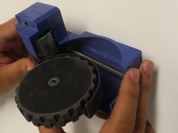

    • Once the screws have been taken care of, the wheel component (with the spring inside) can be removed from the main assembly.
  6. iRobot Roomba 595 Pet Series Wheel Spring Replacement: crwdns2935265:06crwdnd2935265:01crwdnd2935265:03crwdne2935265:0 iRobot Roomba 595 Pet Series Wheel Spring Replacement: crwdns2935265:06crwdnd2935265:02crwdnd2935265:03crwdne2935265:0 iRobot Roomba 595 Pet Series Wheel Spring Replacement: crwdns2935265:06crwdnd2935265:03crwdnd2935265:03crwdne2935265:0

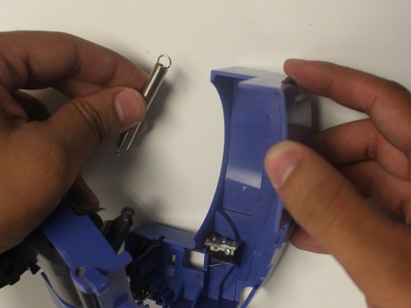

    • Remove the two 5mm screws in the component and gently twist the casing until the spring is exposed.
    • Carefully remove the spring from the component assembly as shown
